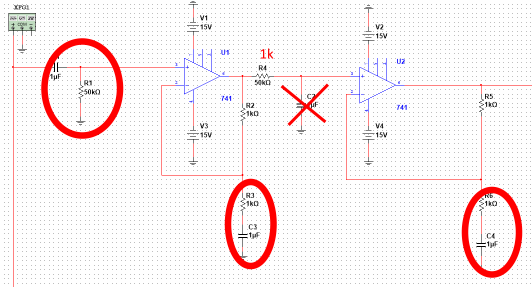

I have drawn what I think it should look like for 2 741's (Note I wasn't sure of the gain so all caps/resistors are at default for now.) Does this look correct?
I had been working on the assumption that i'm too close to the 741's limit and had been looking for alternatives. Would the TL082CP with a GBP of 4MHz be more suitable?
That a good start.
Inside the red circles are the components to set the low frequency point. The three RCs will almost add up so maybe start off with 10z and see what happens. So you know f=1/(2x3.14xRxC)
I removed C2. If you need to slow down the amp put a very small cap across R2.
Change R4 to 1K.
Now do a frequency sweep and see what happens.

So I rearranged f=1/2piRC to get C= 1/2piRf. Resulting in C values of 159nF (1/2pi*50k*20) and 159pF (1/2pi*50k*20k) to calculate my capacitor values for filtering 20Hz-20kHz. How can I remove C2? I thought it was necessary for the high frequency point?
C2 is part of a low pass filter, and will stop any high frequencies going through with the default values you had. You don't need that, or it's resistor, add small capacitors across the feedback resistors.

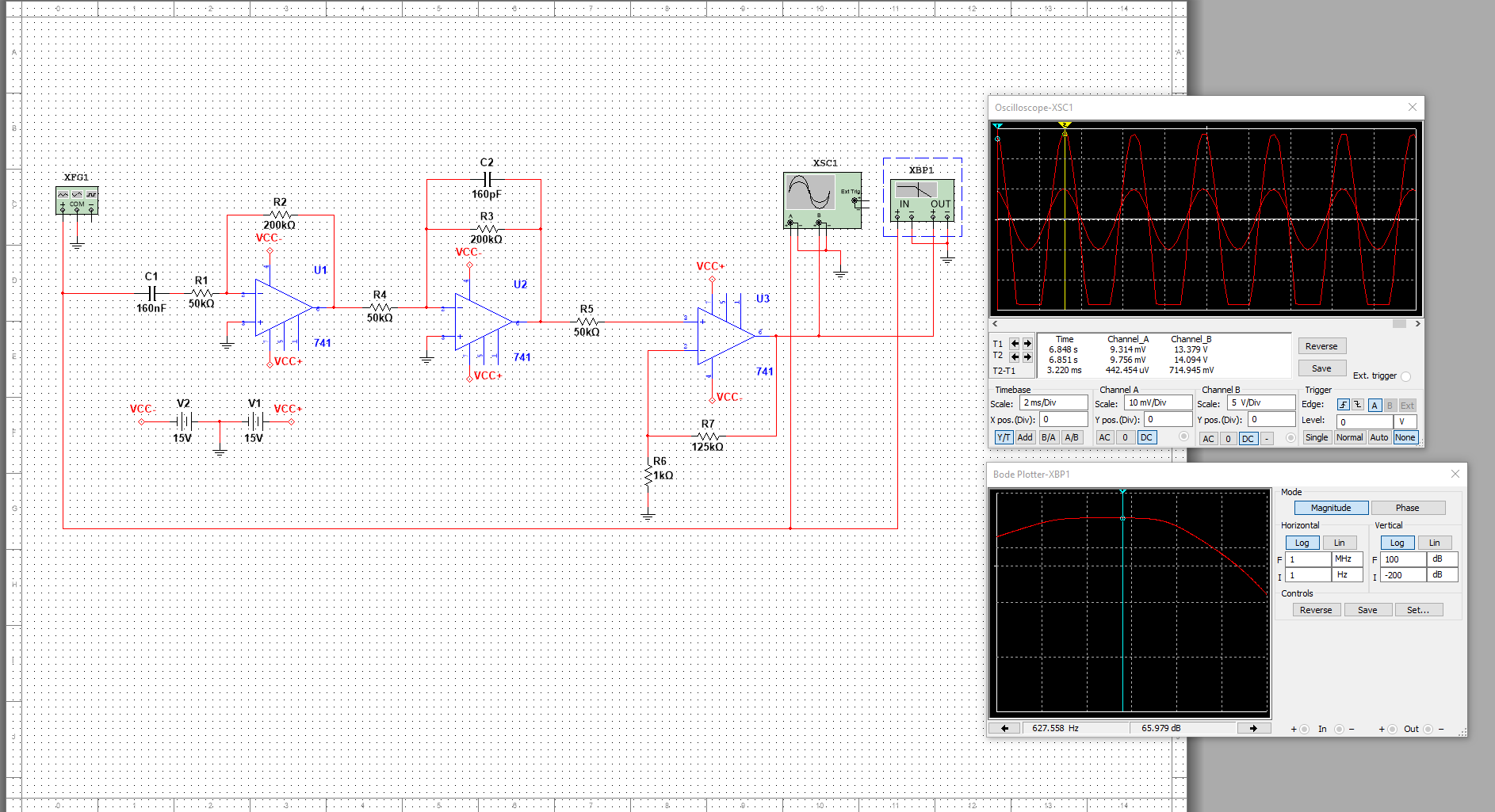

I have however started again with 741's in 3 stages 4-4-125. I have attached this circuit but I remember being told as much gain as possible should be in the first stage anyway.
EDIT:
Input is set to 10mV. I get an output of 14V because i only gave 15V supply, my mistake. Ignore that clipped wave.
Looking at the bode plotter is not what i expected though. It’s my first filter circuit but I expected a sharp drop off outside the frequency range permitted, instead it’s very gradual is that correct?
Input is set to 10mV. I get an output of 14V when I expected 20V (to achieve 2V/mV) so something is obviously still not correct.
Do you really expect to get an output greater than your supply voltage? (Or does this program assume peak-peak values)
Wow i was being especially dense there. That’s exactly why its clipping... I’ll lower input to 1mV, was just the default for some reason.
Thanks.
EDIT: It’s the bode plot that is more “useful” anyway. Not what i expected though. It’s my first filter circuit but I expected a sharp drop off outside the frequency range permitted, instead it’s very gradual is that correct?
Yes, it's not a 'filter' really, or at least not a very good one.
Filters are rated in dB's per octave, and these are pretty well as low as they come.
You can easily improve it somewhat by adding filtering to every stage, instead of only one for each.
The bottom part of the output is clipping because the 50k value of R5 does not match R6 parallel with R7 (almost 1k ohms).
The max input bias current of a lousy old 741 opamp is a whopping 0.5uA which produces 25mVin R5 which the opamp amplifies 126 times to produce an output offset voltage of 3.15V.
The output offset voltages of the first two opamps cancel because the second opamp is inverting and is the same circuit as the first opamp.

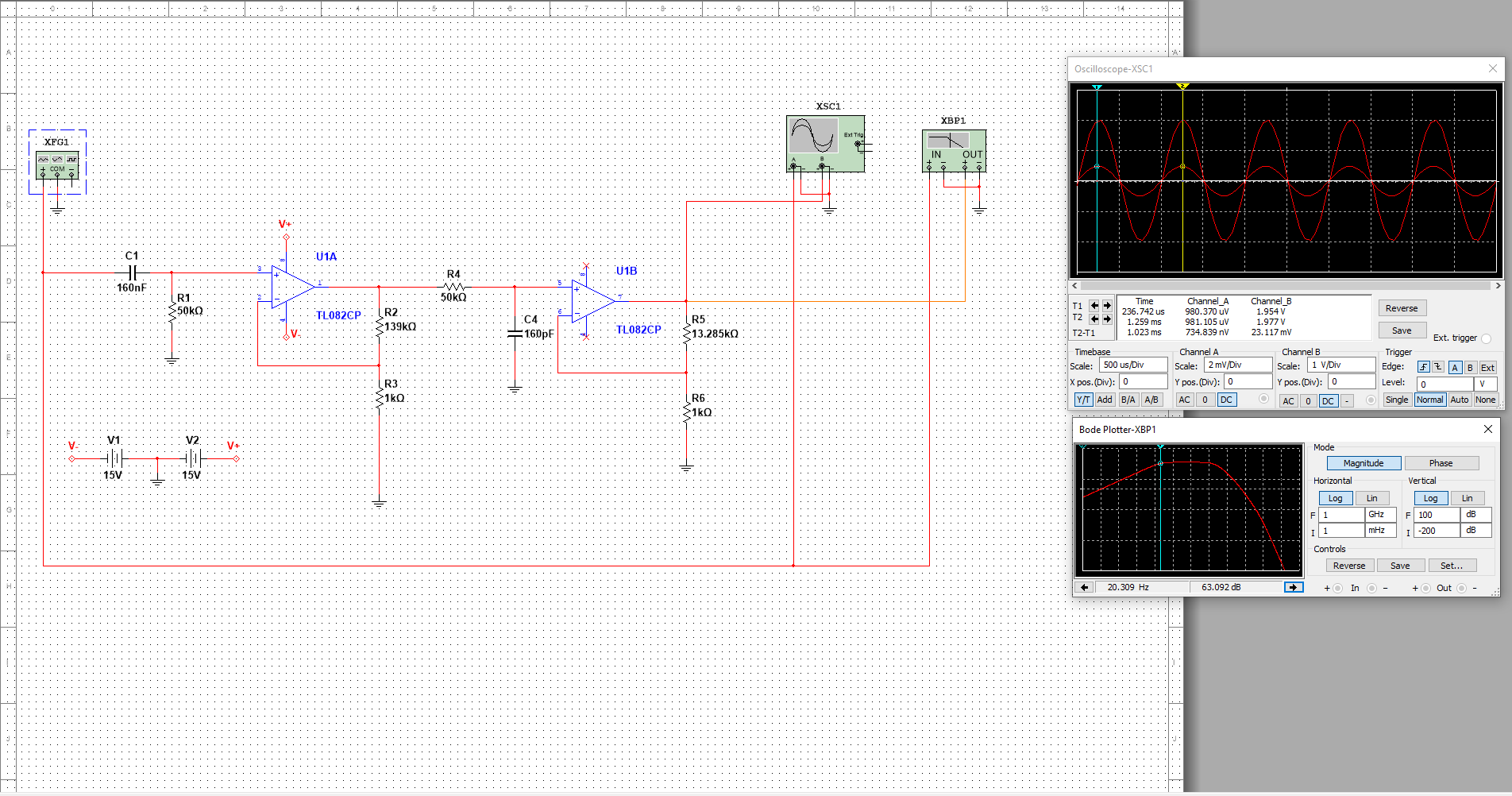

I've scrapped the LM741's and got a couple of TL082CP's on order (I know its 2 op amps in 1 chip but these things are easy to lose!). I will explain why i moved away from 741s in my report so it's all worth it. I have simulated the below, it looks ok to me. Thoughts? Again this is my first experience with filters so i'm not sure how it should behave.
Your filters are very simple so they will not do much. At 20Hz and 20kHz the output level will be down a little. At 10Hz and 40kHz the output level will be down only a little more. Then at 5Hz and 80kHz the output level will be down a little more. Then at 2.5Hz and 160kHz the output level will be …..
The first amp has high gain while the second is only 14.
The first amp must have a GBW of 3mhz.
I would reduce the gain in the first amp.
The TL082CP has a GBP of 4MHz so I thought being under 3 would be fine? Also my lecturer said to put as much gain as possible in the first stage so thats why I did that. I will reduce the first stage gain later and see if it makes any difference.
I know its a large bandwidth but how would I make the filters more effective? The examples I find in textbooks for example are very simple, usually only 1 op amp with a gain of say 10 and small bandwidth.
Refer to post #13, adding simple filtering (low and high pass) to every stage will improve things somewhat with little effort.
But there's no real need for anything else, unless the specifications require it.
It would also add the bonus of removing the DC coupling between stages.
