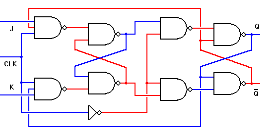

I'm trying to replace the rocker switches in my car for some push buttons. I have asked the manufacturer of the switches I have chosen if they do them as a latching type, but they don't. So here is my Dilema :? .
Each circuit will have only one momentary push button and the circuits need to latch. :shock:
I have a rear fog light that needs to come on when the button is pressed and go of when the button is pressed a second time. I assume that the circuit will first drive a relay, that will in turn supply the fog light.
The second circuit wil operate as follows.
Push button press 1 - Fan speed 1 signal sent to relay.
Push button press 2 - Fan speed 1 and 2 sent to relays.
Push button press 3 - All fan signals removed.
Any diagrams or advice would be much appreciated.

Could I use a 4 bit shift register and set the data high. Use the signal from the push buton with a debounce circiut to send the clock signal. Use output 3 to reset the shift register. Use transistors to drive the relays. Am I going in the right direction?

hey dude look up KJ Flip Flop on google i would post a pic but damed if i can work out how............ oh there ya go i worked it out
ok forget the pic this dude has done exatly what you want allready
http://www.cpemma.co.uk/flipflop.html

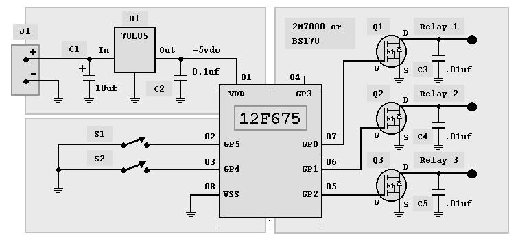

Hi Lee,
That would be a perfect application for a little 8-pin PIC microcontroller (approx. $1.50 USD)... The switches are easily debounced in software... Use the MRF series N-channel MOSFETs if you need higher current or more heat dissapation... Connect the relays between each relay output pin and 12 volts...
If you're not familiar with PICs, this is probably not the best solution...
Have fun... Regards, Mike

Thanks for the replys guys. I got the circuit working by using a 4 bit shift register with the data set permanantly high, the clock pulse via a simple debounce, and output three connected to the reset. I have tested the circuit and it seems to work perfectly. It also gives me the option of creating a three speed fan latch very easily.
