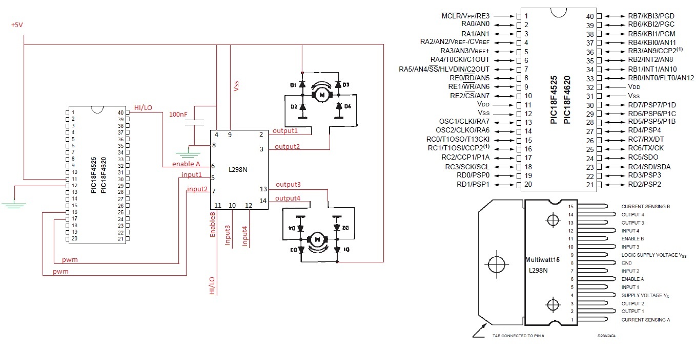

I'm trying to make a 2 wheel self-balancing robot - right in the initial phases.
I am using a PIC microcontroller (PIC18F4220 or PIC18F4620) and a L298N Full H-bridge.
I have learned how to use PWM to control speed of the individual motors - but only in one direction.
Currently, I can controle 1 motor for speed and direction using the 2 PWM pins on the PIC. I would like to control both motors for speed and direction (independantly) using the PWM outputs from the PIC. How can I do this with just 2 PWM pins available on the PIC? Do I need a different PIC with more PWM outputs or is there a way to accomplish this using just 2 PWM outputs?
Any help will be highly appreciated!

Thanks for the reply! My current circuit diagram is attached.
Here is the issue that I am having with controlling two motors:
I want to control the motor speeds using the PWM function from the PIC. I am using 2 output pins from the PIC to enable/disable the 2 bridges in the L298N. I am doing this by toggling the output b/w HI and LO.
The PIC has only 2 PWM outputs available.
How do I control - through this single PIC - both motors for speed as well as direction? Right now both my PWM outputs from the PIC are tied up with one motor. Do I need a PIC that has more PWM outputs? Or is there a way for me to control both motors through just 2 PWM signals?
The motors that I am using have a peak current (when stalled) of 1.3 A - so the L298N should be O.K to handle the load. I would like to stick to PIC microcontrollers and H-bridges as I am familiar with them.
Thanks again!
Best,
Usman
P.S Some other questions - some explanations on these would be helpful for me as wel:
- Do i need all 4 diodes on each motor? What would be the difference if I used just 2?
- Do I need a seperate capacitor for pin 9 of the L298N?
- Do I need a seperate capacitor for the motors or the current arrangement will be O.K?
You need some logic in front of the in pin that will send the pwm to the correct side of the bridge. It can be gated with a forward reverse signal from the pic.
Yes
I would add a large cap on pin 9--say 100ufd.
The schematic shows pin 9 and the motor on the same voltage if they are different I would add the 100 ufd, to the motor supply. If that is the case I would then add just a .1 ufd to pin 9.
The only pins on the L298 which need a PWM signal are the 2 Enable pins (EnA & EnB) :)
You don't need any logic.
Then simply supply In1 and In2 with a '10' for forward and a '01' for reverse (or vice-versa).
