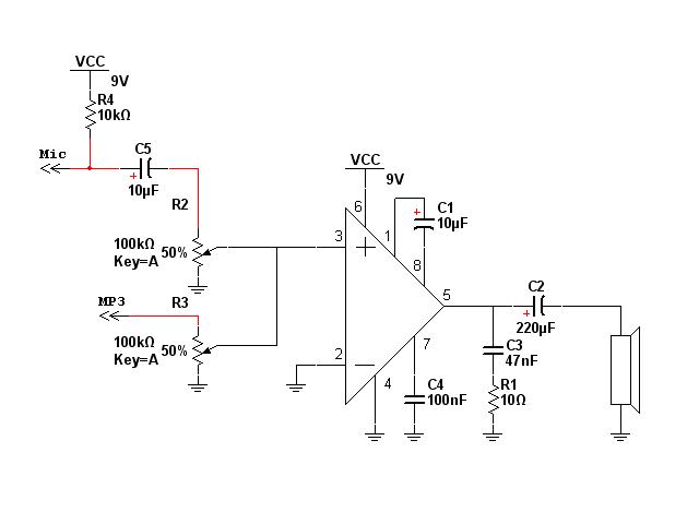

Hello. I'm wouldlike to take two of **broken link removed** and mix the outputs to one speaker. One of them would amplify a piezo mic'd guitar. The other would amplify a media player via a 1/8" phone jack. Would i need to make a buffer/preamp for the piezo? Would i use diodes to prevent output form one amp from feeding back into the other amp?
Thanks for any advice you can offer,
-Scott
Audio signals are mixed in an audio mixer that feeds a single power amplifier. A very simple audio mixer is two resistors.
A piezo pickup needs a preamp with enough gain and a very high input impedance.
Diodes are never used with audio signals because they pass only one polarity and the missing polarity would cause severe distortion.
A speaker has two wires. You could feed one wire with a signal from one power amplifier and feed the other wire with a different signal from another power amplifier. The signals do not feed from one amplifier back into the other amplifier because the speaker is in between.

Instead of using two power amplifiers, I would use two simple resistors as an audio mixer that feed a single power amplifier.
I tried this already:
Do I just need a couple resistors after between pin 3 on both the pots and the amp input?
If the volume control for the guitar is turned down then the tiny 47nf capacitor is driving a low resistance which cuts low frequencies.

I would recommend using the circuit that I have attached. It has a gain of 200 but since both of the inputs are connected to pots then you can vary the input voltage so that there is no clipping on the signals. You don't have to have a preamp to the mic, but you can. I made the schematic so that it would not need a preamp. Even with this circuit, your guitar may be louder than the actual amp. You could connect it to a larger amp.

Sorry, but that's even worse than his was :D
You can't just connect the sliders of the pots together like that.
It worked just fine when I did it. But then again my 386's are in very bad shape. Either way, a DC blocking capacitor, or 2 10k resistors on the wiper of each pot should resolve the issue.
The value of C5 is much too high. Use a 220nf (0.22uF) film capacitor.
Ok, revised again. Does everything else look OK before i build this thing? Should the pots really be 100k?

A film capacitor (for C5) is not polarized.
If a 10k volume control is used then it will load down the electret mic which reduces its output level, and the coupling cap C5 must be 2.2uf.
Thanks Guru... the "mic" in the diagram will actually be a piezo. Does that change things?
