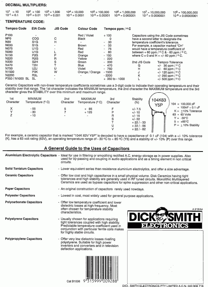

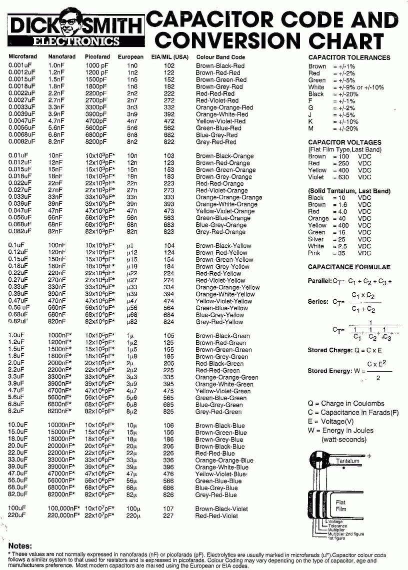

Here is something to help you.
:) hello hotwater wizard nice to see you here to , you saved me haveing to post my capacitor conversion charts here ,
11uf ceramic cap code
these are handy to have , one day i walked into altronics store here and arsked for what i can easily remember as a 104 or o.oo1uf capacitor, and for short all there capacitors had the converted numbers on them and they dident have a converter chart , nor did they know how to convert they were hopelless at knowing it
