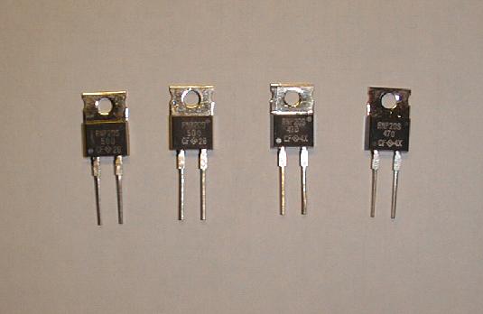

Hi Dknguyen,
Do a search for thick film resistors, Vishay produces some.
The one's that I use are not from Vishay.
https://www.alldatasheet.com/view.jsp?Searchword=RNP20S
rnp20s-jpg.12107
