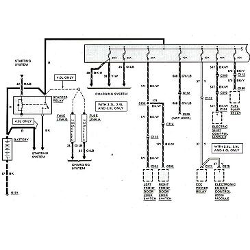

So I bought a 1986 Ford ranger that needed the body harness completely rebuilt . As I'm ripping out the old harness I noticed something that looks like a wire nut with about 6 wires inside of it. Has anyone seen anything like this? Was this Normal for fords back then ? Or was this the result of someone not knowing what the heck they where doing? Please let me know what you guys think about it ! I can't even wrap my head around why it was done like this or how to repair this. Should I just run new wire and do as they did? Open to all suggestions!

These were definitely live wires! 3 wires coming from the alternator, 2 wires fusible links , and one other miscellaneous wire that goes to the dash somewhere, and one wire that's completely fried with no insulation just copper showing.
I served my apprenticeship at a Ford dealership and got my license in 1986. I do not recall ever seeing a splice joint like that on a Ford vehicle so I would be temptet to eliminate that and clean it up. If memory serves correct, the only fusible links on the truck were down at the starter and I think one at the starter relay. Hope thst helps
How would you go about eliminating it. There are not really any schematics I can find for this truck. Also there were 2 fusible links in that bundle .

Circuit diagrams are scarce and the ones I have found seem to have a few color codes wires missing. Any tips where I can find them? Would a Ford dealership give them to me?
There is quite a bit of information regarding wiring on this site:
The colours and wiring diagram sections for many of the main items & functions are on or linked from this page:
There may be other pages with more info.
If you can identify all the wires for all the listed sections & items, hopefully the leftovers (if any?) should be a bit less of a problem?

Sorry I’m late. Fusible links went away at the body change in 86-87 for larger trucks. I’m assuming rangers were similar. Fusible links are visible in the pictures above. On fords they look like a large black cylinder inline with the wire. They are a pain and one of the reasons I’m building a 1996 truck to look like an 86 rather than just buying an 86.
From your photo, the main feed wire was cut off. There'd normally be a single feed wire at one end of the molded insulator fed from the battery or a fuse block output. In this case, the wires were used as a common tie point from an internal feed. Tracing each wire from the molded insulator will tell you if rewiring the harness is worthwhile.
