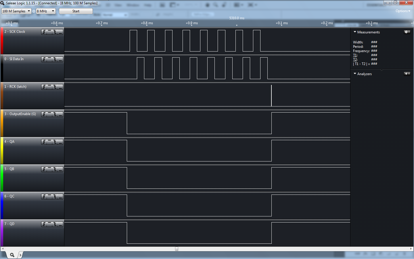

Howdy gents,
Had some time off during Christmas and thought I would *finally* use some shift registers. I have the 595 wired to a LED bar graph and it flashes faintly, I can just barely see it, even when passing all zero's or 0b10101010 it seems to be all the segments. I'm sure the solution is something easy (and stupid) but the it has eluded me of late.
Using a 18f4620 and ST M74HC595B1.
thanks!

Here's a Saleae screen shot of the 595 IC.
The clock pin on the 595 should not be strobed until the data bit is present on pin D0 of the 595. Also, the 595 uses an SPI interface so it shifts in/out MSB first.
Try this code instead for your ShiftOut function -
void ShiftOut(unsigned char data)
	ClockPin = 0;						//default clock low
	DataPin = 0;						//default data low
	LatchPin = 0;						//default latch low
	unsigned char bitcount = 0;				//init bit counter
	for(bitcount = 0; bitcount < 8; bitcount++)		//send 8 bits
		DataPin = 0;					//assume MSB = 0
		if(data & 0b10000000)				//if MSB = 1
			DataPin = 1;				//send 1
		ClockPin = 1;					//strobe clock
		ClockPin = 0;
		data = data << 1;				//left shift data bits
	LatchPin = 1;						//strobe latch
	LatchPin = 0;

Thanks Jon for the example. I borrowed Pommie's code originally but ended up thrashing around making changes thinking it was a code issue when in fact (rookie mistake) it was my breadboard. :mad:
Nothing like chasing ghosts for two days. Fired up the soldering gun and made a proper dev board.
