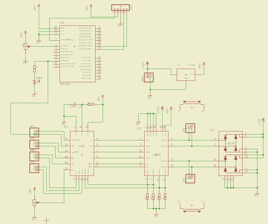

Can anyone give me some guidance on how to 'do' pfm i.e. pulse frequency modualtion in MCC18

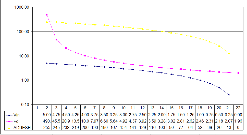

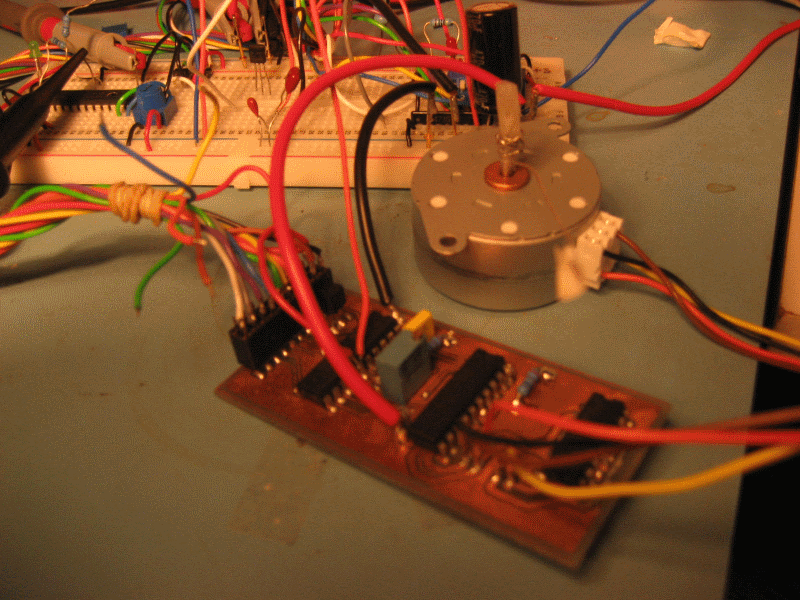

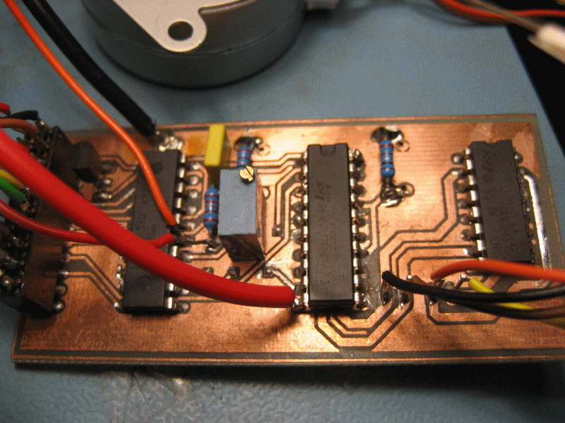

I've built a little stepper driver board around a L297. Using an 18f2420 I want to provide a variable clock signal so as to vary the speed of the stepper. Can do this at the moment but the the outputted clock signal ain't linear.
Thanks in advance for any help.
