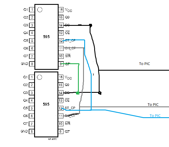

About this connection. Which one are latch pins? If I get well I'm connecting pins 11, 12 and 14 to three I/O pins on PIC. That's how I connect first HC595. How about next one, and another four?

I was referring to pin 12 as the latch pin, you got it right.
All six shift registers share the clock and latch lines. Pin 9 is to be connected to the data input on each successive register. Pin 9 from register one goes to data in on register two, from two to input on three and so on.

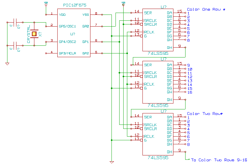

OK, please look at my.. let's say its draw, and decide is it all right.
Sorry, really sorry, about it. It's done in paint. Will it work?
Do I have to connect GND and VCC of register to power? Or any other pins to something?

Yes all grounds need to connect and all + power connections need to be made, on all chips. I recommend the PIC12F675 or PIC16F627A. They're two of the most commonly used PICs and have plenty of code examples online for you to go from.

For columns on scheme I should just continue adding registers?

Correct, extend the example to include the final three shift registers. The next one in line will be color 2 rows 9-16, then columns 1-8 followed by columns 9-16. Don't forget that the serial output connects to the input of the chip after it.
