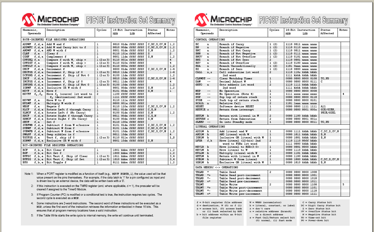

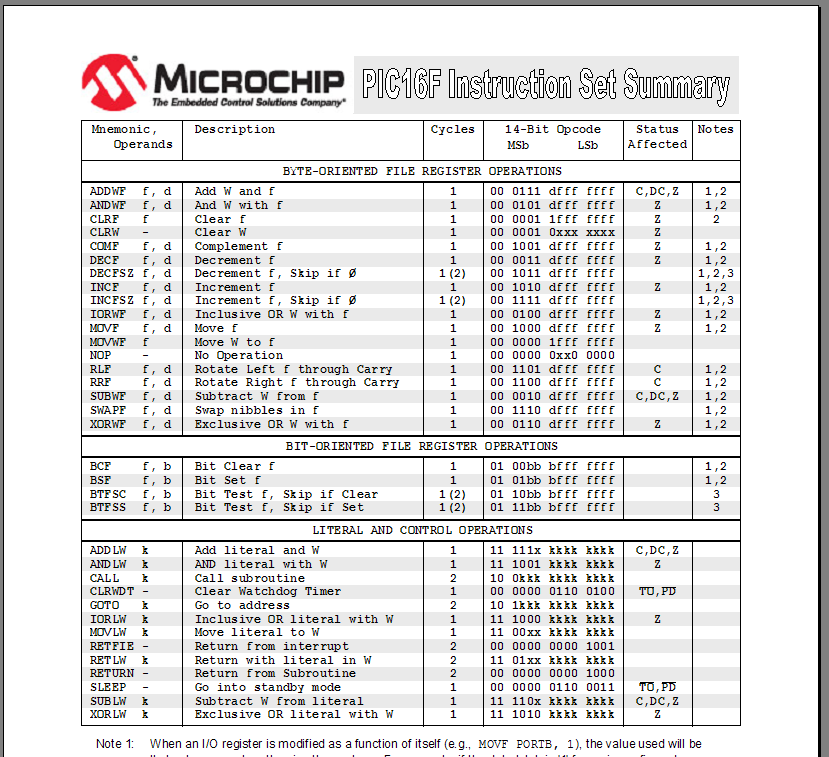

Not bad. Here's a 16F Instruction Summary I did a few years ago (pdf). Also did an 18F Instruction Summary PDF for 11x17 (prints very nicely on 1200dpi laser printers).

Sid Katzen has some nice instruction set references for 12, 14, and 16-bit core PIC microcontrollers on his PIC resources page, which I have been using.
It's hard to make the instruction set look much different than Microchips. Not sure how useful the Opcode part is for a beginner... I'd like to know the rule for the direction bit, what is the default if not specified? is it always W or F or variable?
