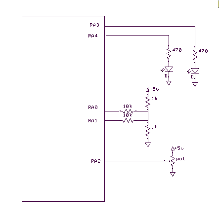

Sorry, but still it is not working, I think it has some wrong connection, unfortunately, I'm not able to upload the circuit, thou it is very simple ,
*the ouputs RA3 & RA4 ((Pin 2 & 3) are led connected to ground through 470 Resistors,
* Vin- which the reference is 5V divided by 2 1k resistors and connected to RA0 and RA1 through 10 k resistor.
* Vin+ is a potentiometer connected between 5v and Gnd. The mid terminal connected to RA2 (Pin1)

Is it connected like this.?

* YES the drawing is correct except for the two 10k. I've connected one of them to one of the inputs.
