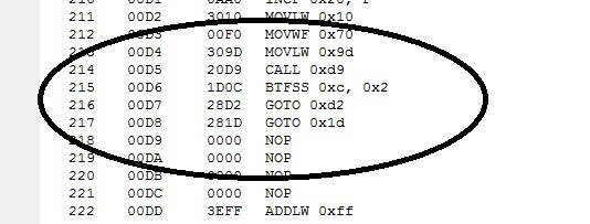

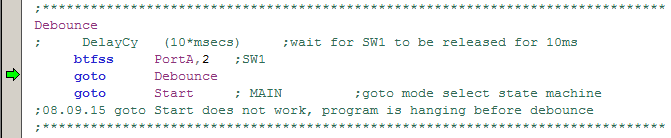

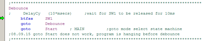

Program hangs here:
Program Counter (PC) goes to "goto Debounce" as if SW1 were low. Voltmeter on SW1 shows 4.95V. When SW1 is pressed, voltmeter goes to zero. Pull-up resistor on SW1 = 22K. Pressing SW1 has no on PC.

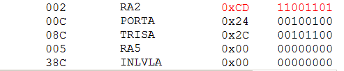

I am a bit confused about what the Watch window means:
PORTA does not change regardless of whether SW1 is pressed. Why does "RA2" show 8 bits? As the PC goes "btfss" and "goto debounce" RA2 changes from 0xCA to 0xCB (i.e., bit<0> is set and cleared).
I have even gone so far as to use the initialization procedure for Port A in Example 12-1 of the datasheet. Comparators are turned off.

just out of curiosity, have you made sure what bank you are in? the tris banks are not the same as the port banks. aka=banksel
its been awhile since i've used assembly,.
TRIS registers are in Bank1, which is selected as the first instruction after "Start." On the right most column, I try to keep track of the registers, when it is important. MOVLB selects the bank based on the literal.

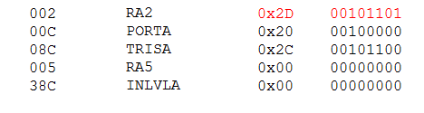

Just reassigned SW1 to RA5 (pin2) , at least it is being recognized now. I am still confused about what the Watch window means for RA2. The "equivalent" Watch for RA5 shows all zeros, regardless of whether SW1 (now assigned to RA5) is pressed.
John
Darn it, you are good.
INLVLA on reset is 000100 and that is what it read in the watch window. Added CLRF INLVLA ;|B7 and now the program
works just like it did after I changed SW1 to PortA,5. I still don't understand RA2 in the watch window (with SW1 pressed):
But, at least bit<2> of RA2 (whatever that means) is changed with SW1.

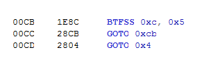

Of course, the program code that is accessed by a goto is:
I checked the Disassembly listing on the slim chance that paging had reared it ugly head. It is not a paging issue. When the program goes to Debounce, the PC simply alternates between the lines beginning "btfss" and "goto debounce" regardless of the input signal. This is the watch window. PortA,2 (aka SW1) should be read as set, but it isn't:
Thinking there might be something funny in simulation about reading the first instruction after a goto, I inserted two NOP's and it did not affect anything. It is just not reading that input port and responding as I want it to respond. Voltages on the pin with a voltmeter are correct, high= 4.95; low=0.00. (The delay is commented out,because under hardware simulation, it it interminable.)

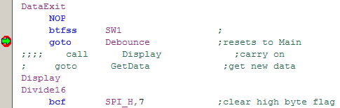

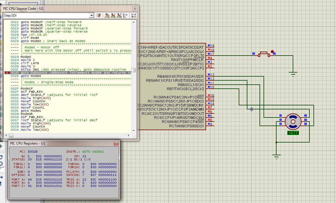

I did find one place that has a goto immediately before the program hangs:
None of the other goto's got to the hang. Of course, this is one of the early (actually earliest) goto, unless it is an error. DataExit is the last step in the USART, which is in-line code, not interrupt driven. I will omit t and see what happens. My guess is that the hang will just occur after the next "goto."
I am perplexed why the "debounce" from a goto is in the start sequence works fine, but when it is called later later it does not work. There is, of course, only one "Debounce" routine.

You mentioned using ISIS simulator. I guess that is part of Proteus, and there appears to be a free download of Proteus ISIS. I am assuming the pro version is quite expensive. Have you used the free version?
John
The free version has no processor models.... I think the cheapest pic model is £150.... I have the full pic complement.. And yes it is over a grand...
£150 seems reasonable, if it can do good peripheral simulation of enhanced mid-range PICs. Is it pure simulation or does it actually use the hardware like the MPLab ICD3 tries to do ?

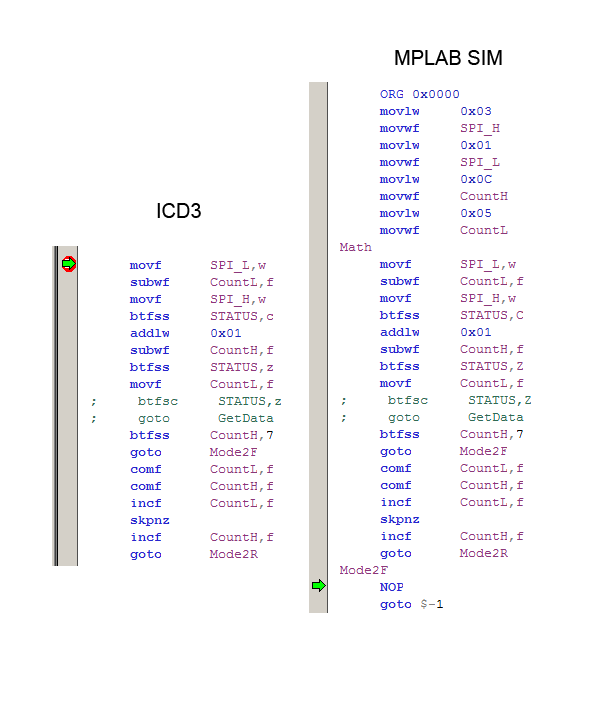

Anything would be better than dealing with a simulator (MPLab ICD3) that can't follow simple instructions like btfss or subwf,f. I am sure there is a reason for that apparent failure. I just haven't found it.
Here's an example: I have a short 16-bit subtraction routine. It works great with MPLab SIM and even gives the right answer! (sarcasm). That is, 0xc05 - 0x301 = 0x904. The same program copy-and-pasted into the thing I am testing with the MPLab ICD3 simulator (i.e., the simulator that caused me to start this thread) gets the wrong answer. I have made several snippets to illustrate the steps and will get them composed into something here. Need to get some sleep and review again with brighter eyes.
The basic problem seems to be that the ICD3 simulator can step through a program but for some reason it may ignore an instruction like btfss or subwf. Looking at the LSB in the above example, 05-o1 = 4 in hex or decimal, but MPLab ICD3 showed 05. In other words, although the cursor moved, the action wasn't performed. Of course, that screws up subsequent parts. Other parts of the program work fine.
I usually use MPLab SIM, and although it is pretty limited in simulating peripherals, it works well within its limitations.

Hello,

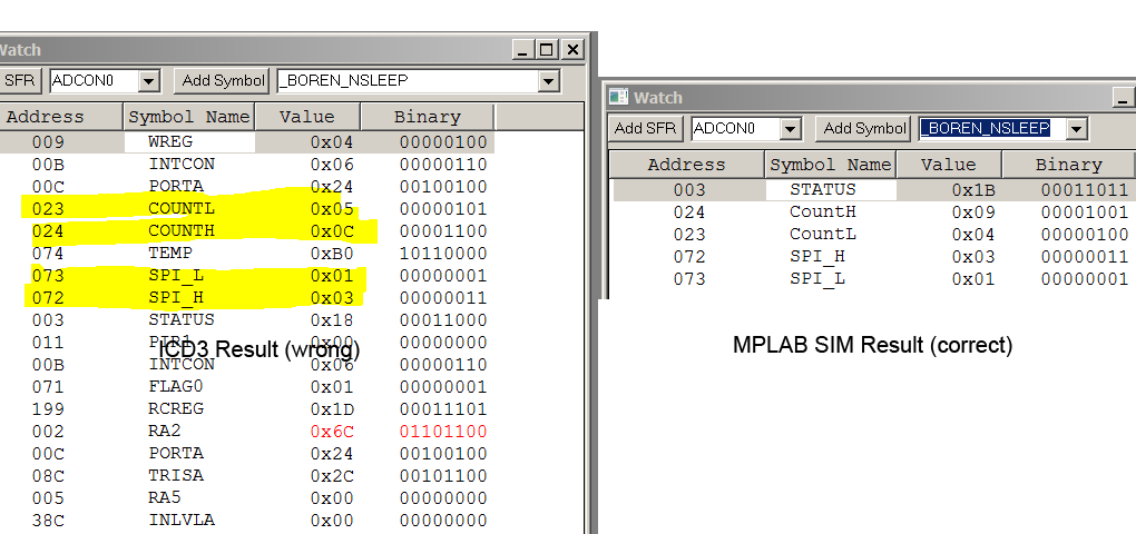

I saved several snippets earlier today showing the difference between an MPLAB ICD3 (hardware) simulation and the MPLAB SIM software simulation. Suffice it to say, the ICD3 simulation goes through the subtraction steps and doesn't subtract. That is, very much like going through a BTFSS instruction and not being affected by the status of the targeted bit. Here are two composite images of my comparison.
The first is a side-by-side snippet of the two programs. In the SIM program, I had to load the registers, as the data in those registers comes from another PIC via the EUSART peripheral of the 16F1829.
And here are the results from the watch window. The subtraction equation is 0xc05 - 0x301 = 0x904 .With the routine that was used (source = PicList), the result of the subtraction ends up in the same registers as the number from which the subtraction was made, i.e, CountH/L.
It is not a particularly long program, but it does have some math routines to take raw, 14-bit data from an encoder and adjust it to display a change in position. My indicator is a stepper motor with about 600 full-steps per revolution, so I reduced the original data to just 10 bits. Still, I need to check some details of the programs, and that is almost impossible to do with just hardware.
As for why the ICD3 doesn't simulate properly, I could not find any examples of that behavior on the Internet. There are plenty of discussions about difficulties using the simulator, but no examples that I could find of it giving wrong math results once the user has the simulator working.
FWIW: "Temp" is the receiving register for the data. In the example shown 0xB0 becomes SPI_H after removing the address bit (7) and dividing by 16.
