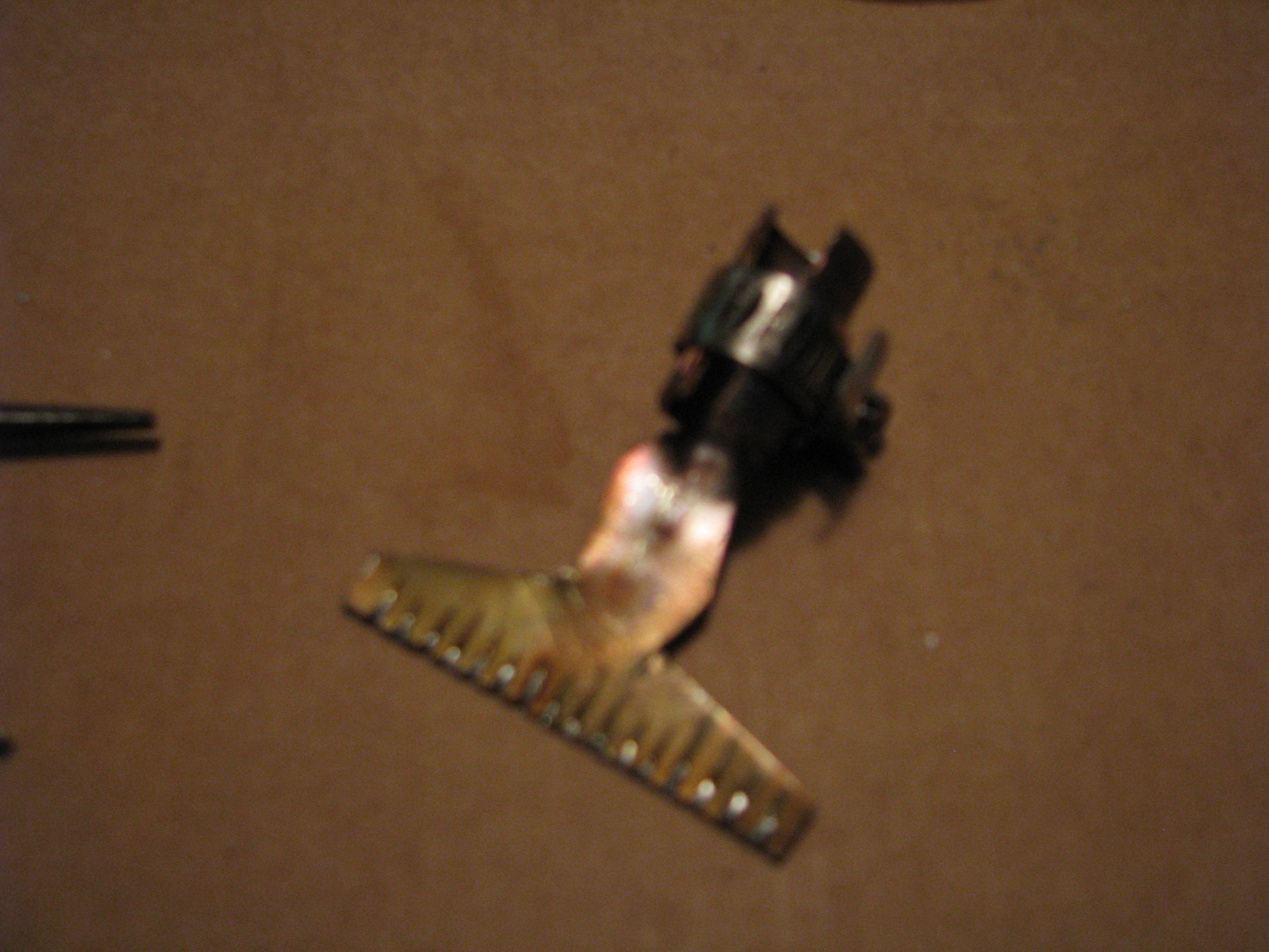

I'm trying to replace a simple 16x1 LCD character display but am having difficulty removing it.
I've tried desoldering the 16 pins with a solder sucker, Ive also tried making a tool that fits on the pins and attaches to a regular soldering iron to heat all the pins a once, the unit will not budge.
If I could just cut the pins first to remove the LCD then take each pin out separately I'd do that but I cannot get ANYTHING between the LCD PCB and the main PCB due to its placement.

If there are any other techniques anyone can suggest I'm all ears as I've scoured the internet looking for tips and tricks but am unfortunately fresh out of ideas.

I made this....
maybe it will work?
