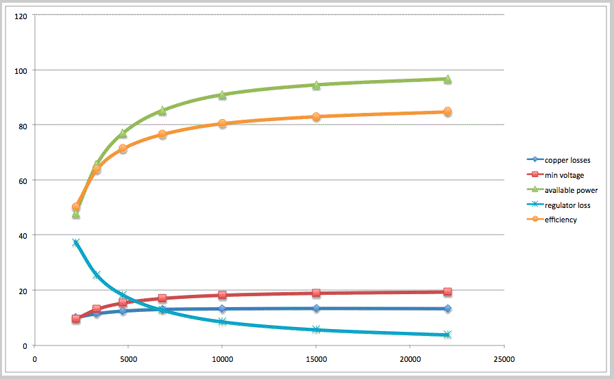

Note that the more "nice big smoothing" capacitance you add to the output filter, the more heat you dissipate in the transformer since that increases the peak current drawn from the transformer. So the optimum capacitance for minimum transformer dissipation is such that the low voltage point on the ripple output at maximum current is just above the minimum drop-out voltage required by the voltage regulator (I assume) you are using.
That is true, but the effect is not very marked.
I ran some figures for this transformer, and I've attached a graph of the results.
With a 2200 μF cap, the copper losses are just over 10 W, but there is huge ripple, probably too much for a 2200 μF capacitor and only 9.5 V is available.
With a 3300 μF cap, the copper losses are 11.5W, and 13.1 V is available. This is probably usable.
Going all the way up to 22,000 μF, the copper losses are 13.4 W, with 19.4 V available.
What is happening is that even with capacitors that are far too small, there is still a large peak current as the capacitor is charged each cycle.
So yes, the optimum capacitance is the one that gives the drop-out voltage. However, if you go larger, which reduces stress on the capacitors and gives more safety margin, the increase in transformer heating is small.
If you design for a large ripple, there will be larger losses in the regulator and overall efficiency is worse.
But note that the secondary copper loss for the rated RMS current is 8.36W total (both windings) so if you go above that value you may cause overheating and deterioration of the winding insulation.
