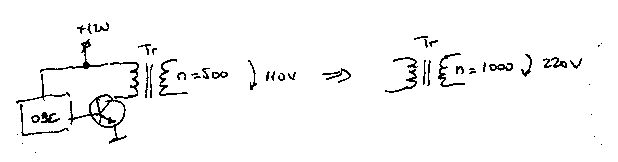

glebka11 said:
I have to build a 12V DC to 230V AC converter.
I have read a lot of articles about those converters, but they are all for 110V but not 220V
You must doubled the number n=500 for 110V ==> n=1000 for 220V
yeah, you can use a smaller transformer with less windings and trade it for frequency.
Something like 80Khz will be sufficient. I don't know how do do the calculations over inductance and current/voltage and frequency, but all computers use this form of voltage conversion but with a tiny transformer for its output.
I don't know how you would convert that 80Khz ~ signal into 50/60Hz ~ though.
