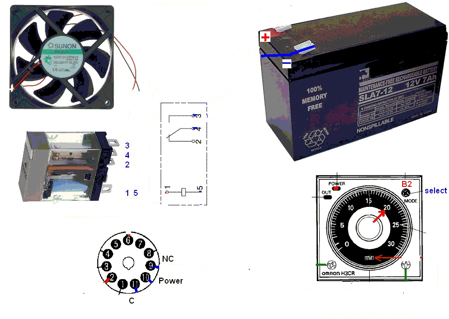

Hi, i'm manager of a shelter in a provincial park and i wish to put the restrooms blower on a timer i have te material now i need the knowledge...
I need help to hook up
12v blower
OMRON TIMER H3CR-A +base
OMRON G2R-1-S relay+base
12volt battery pack
in attach here are my parts if somebody could point me out how too hook up together all this it would help me a lot

I assume you have no AC power which is the reason for the battery. The system will likely only run a day or two before the battery is discharged. Do you have a way to charge the battery every day (solar panel for example)?
I'm don't know which specific timer model you have (H3CR-A is the basic part number which includes many different sub-types). If it has contacts, you don't need the external relay. Connect the the positive fan wire to pin 1 on the timer and the negative fan wire to the battery negative terminal. Connect pin 3 of the timer to the battery positive terminal. If you post the complete timer part number I can be more specific.
Connect pin 7 of the timer to the plus voltage. Connect pin 2 of the timer to the negative voltage. These power the timer.
I hope you bought **broken link removed**, that runs on 12Vdc. Since the timer has its own relay, you do not need an outboard relay. The omron timer draws more power than the fan, so a custom design using a 555 timer ic would give you much longer battery life. You likely also need a solar panel/solar charger regulator so that you do not have to take the battery home every night...

yes i bought the 12v H3CR-A model as shown in the link in your post.
the salesman at the electronic shop sold me the relay telling me that my blower (12 v 9 amp) was to high amp to operate timer without relay. what are your opinions

the Sunon fan shown in you post will draw less than 1A (10W@12V). The OMRON spec sheet shows that the built-in relay will switch 5A @250Vac, so it will switch your 1A Fan directly, no extra relay required.
This timer draws 0.2W just sitting there even when the fan is not running. This timer is way overkill for your application. You could do the job with $5 worth of parts between the battery and the fan.

the sun on fan picture was used only to replace the picture of the actual blower (unavailable). its a 12v 9 amp blower that operates on a 10X 6volts 200 ah battery bank. so that is why i think i have to put the relay somewhere...i'll wait for your suggestions
the objective of that timer was to turn on the fan 1 our than off one hour and again.
If the fan draws 9A, then yes, the relay is required. Are you asking us to provide a wiring diagram? If so, I will work on this later today....

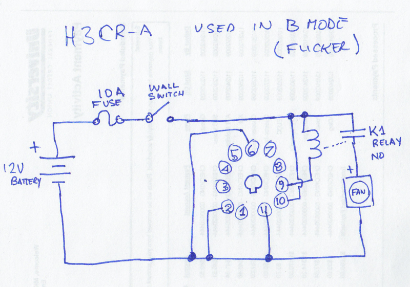

the blower doesnt suck the air from the room it is actually located under the shelter and suck the air from the poo tank and blow it out through a chimney up on the roof. that is why it has to be powerful. It is also why i dont want to have any other person having control on the switch than me (the switch is not in the room) so when i arrive i turn it on and i let it go on automatic mode on hour off 1 hour on 1 hour off 1 hour....before it used to run 24/hours a day it was to much for the batteries. that is why i decided to install the timer.

Ok, so you want a toggle switch. When the switch is OFF, nothing runs. When the switch is ON, the timer is powered, and runs as long as the switch is ON. While the timer is powered, the timer should toggle between two equal settable periods; FAN ON period, and FAN OFF period.
The attached schematic should do that. Look at the attached PDF data sheet. Make sure that you have the H3CR-A with no other suffix letters.
