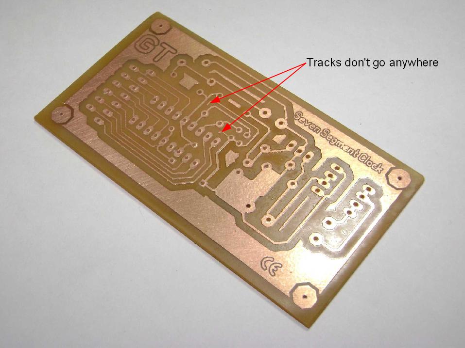

I've noticed that some of the tracks don't go anywhere: were they drawn by mistake and removed after the PCB was etched?

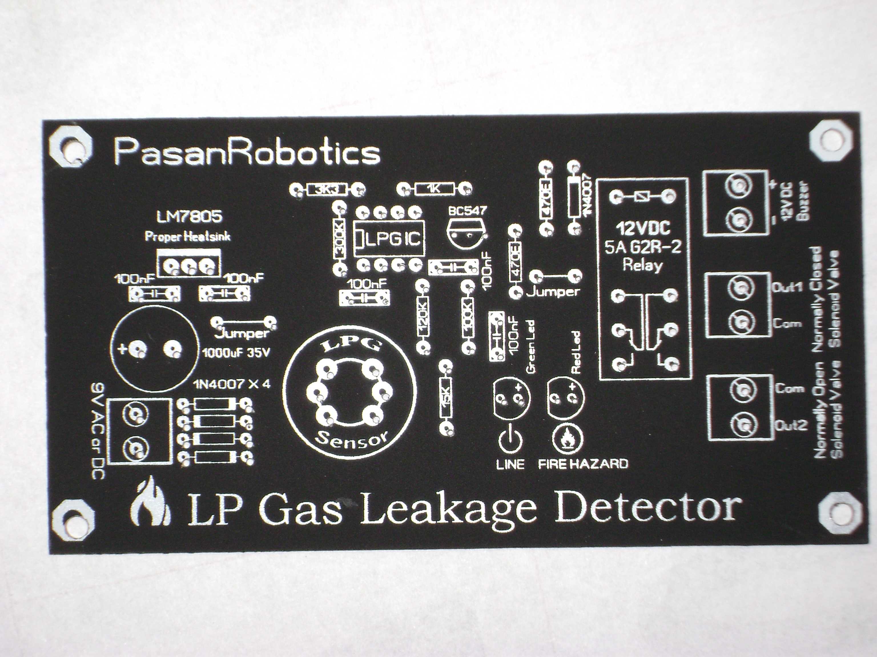

It looks like an interesting method of doing a silk screen. Have you tried toner transferring the silk screen and covering with a lay of conformal coating to give a black silk screen?
I'm talking about using the toner transfer process to put the silk screen directly on to the PCB so you don't have to mess around printing it on paper and gluing it to the board.
Once I've done the toner transfer, I cover it with a layer for conformal coating.

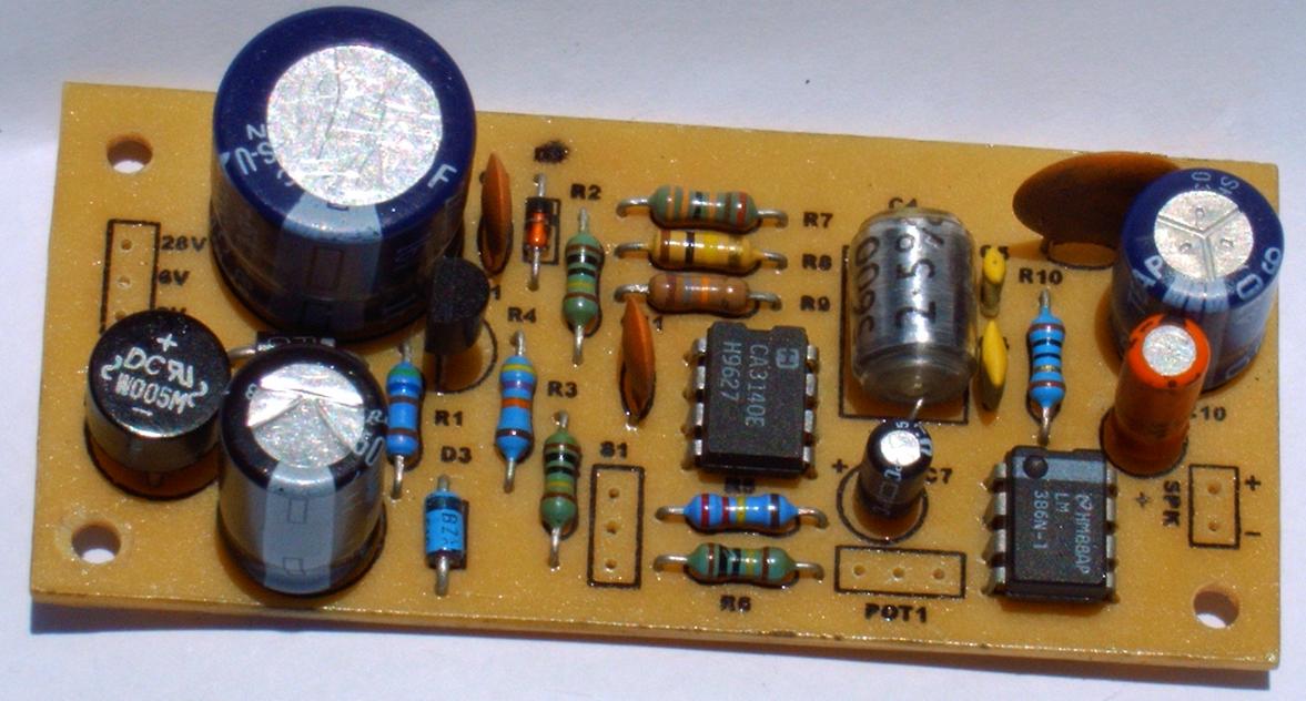

The PCB remains its natural colour and the silk screen is black, see attached.

They're actually no tracks, but "fillers". Making a single sided board the ground fill won't get to any position of the PCB unless you use wire jumps.
Fillers help etching the board evenly. Large copper areas require more time to etch burrying the risk of underetching narrow traces.

I was talking about the tracks pointed to in the following attachment.
Maybe its the filling algorithm going overboard?
It's no problem on a digital board like this, unless it's part of a crystal oscillator but it could be a problem if the track carries an op-amp's inputs which are a very small signal.

Thanks Hero, about the fillers i only use them for Ground or Power Planes also some times just stand alone copper blobs, keeps etching time to a minimum. I guess they will cause problems when doing wireless but never got the opportunity to do so. Tracks are supposed to left alone.

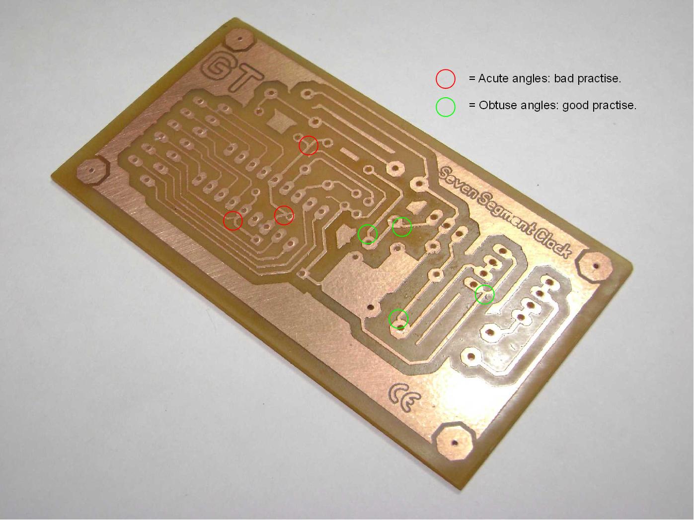

Another thing, I notice you've used some acute angles which isn't good practise because it can cause problems with etching. You might think I'm being picky and it is true that with the track thickness you've used it's unlikely to cause any problems but it's good to get into the habit of avoiding acute angle, so you won't run into any problems if/when you do use thinner tracks.
I've highlighted a few acute angles and some obtuse angles, which are bad and good respectively. There are a many more acute and obtuse angles on your board, I've just shown a few to give you the general idea.
