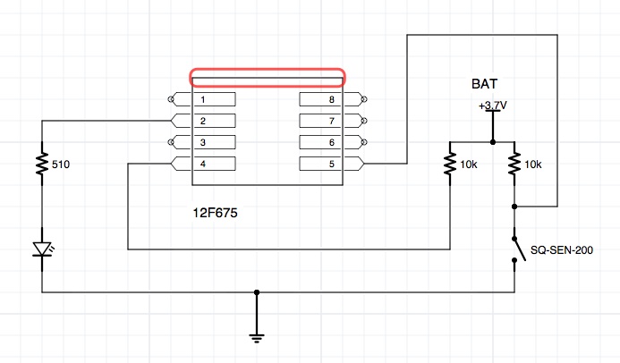

I was able to program a 12F675 with this;

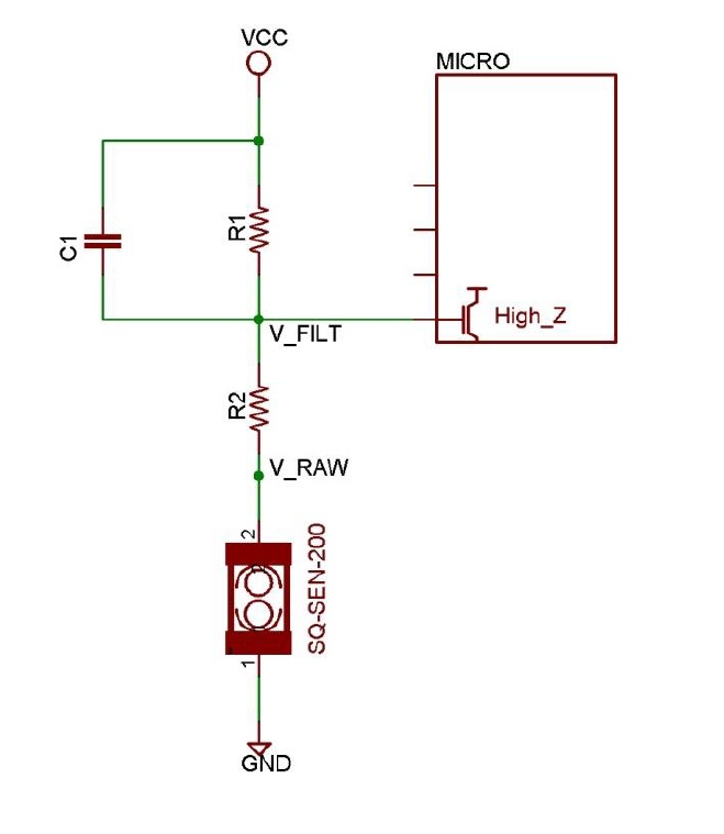

Inserted into this circuit it works as advertised. The SQ-SEN-200 is an omni-directional movement detector.
I get a blinking light when ever there is movement.
Can the same program on the same chip be used with this circuit from the manufacturer website?
I started with a 4.7m on R1 and a 1m on R2. A 10pf on C1. Not sure where to lead in as High_Z on the chip nor do i know where or how to place the LED.
I tried Pin 5 as the High_Z and putting a 510 resistor off of Pin 4 followed by one lead of the LED. With the other lead of the LED going to ground. I was not able to light the LED this way.
