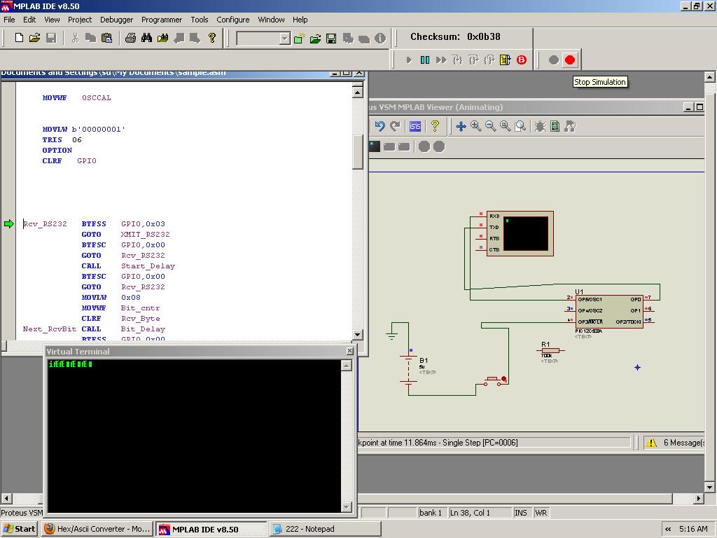

hi guys,
i am using the "rs232 code" from nigel's tutorial in my serial communication experiment. it worked well with my 16f84 but i was thinking to port the code to 12c508 because since it had lesser pins had some appeal to me. it was not an easy transition from 16f84 to 12c508, i ran into a lot of obstacle and tried to figure out what the problem was. like i did not yet know at the time you cannot call "CALL" twice, using RETURN is not allowed also, plus the OSCCAL part and the different setting you have to use when assigning TRIS. But i'm stuck again and don't know what to do next. the character that i send out from the pic is off. plus the character i send out to the pic like "b", when it should be "a" to make GPIO,0x01 go high, still make GP1 go high.
by the way i am using the internal oscillator of 4Mhz
here's the code:

screenshot of simulation:
