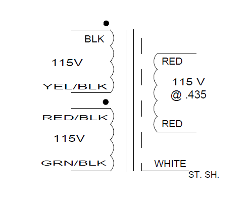

Since you are in the UK you have 220 VAC 50 Hz mains but if you want to go from 120 volt 50 Hz to 220 volt 50 Hz you would use a transformer similar to this one. Transformers work both ways. Looking at the attached image if we 120 VAC 50 Hz to the two red leads and then tie the Yell/Blk and Red/Blk together the output between the Black and Grn/Blk will be 220 VAC 50 Hz.
Transformers like this are common. The link is just an example. Any 220 to 110 transformer (note I say transformer and not converter) will work backwards. Just keep your current requirements in mind.
My original take, based on your original post was that you are in the UK. Your mains power is 220 VAC 50 Hz. That you wanted to step down the 220/240 VAC to 120 vac US mains power to power a small 120 vac to 6 vdc wall wart (power brick). Thus I suggested a simple UK little wall wart that would take your 220 VAC UK mains and give you the 6 VDC 300 mA you seemed to want.
