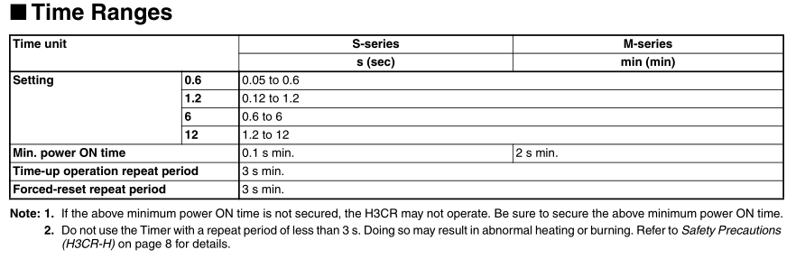

I've never used one of these timers, and I find this bit of the datasheet unclear:
It looks as though Setting '12' (for example) gives a range of times, implying there are two controls; one for selecting the range and the other for selecting the time within that range. Is that the case?
Also, does the datasheet mean that holding the button closed for the minimum 2s (for the M-series device which I take it you have) results in the chosen delay time? If so, perhaps the holding contact use is unnecessary. Try without using it, but press the button for >2s.
I'm currently using the 6 sec setting and I notice I have to keep the button pushed for about a sec before the circuit is fully made. I believe I need the holding contacts to keep the coil energized once I depress the pushbutton, which open circuits. Another thing I don't understand from the data sheets is reading the timer bar graph. Still reading up on it though.

Still worth trying without the holding function. Maybe the time-out delay starts when you release the button. If this is a solid-state timer it may be able to store enough charge during the 2s press to run the timer for the set delay period (just guessing).
It works!! I'm still trying to grasp why it works but she times out perfectly. I appreciate your help and the little push, now I have a nice conversation piece!
