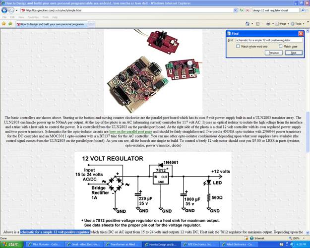

:confused: Hi,
I have a transformer with 20 VAC on the secondary. I run that through a bridge rectifier and come out with 17 volts. If i connect a 220 micro farad cap on that output to ground then the voltage on the cap + keeps climbing to 35 volts. How or why does that happen??
I took the cap out and i get 15 vdc out of the 7812 instead of 12. Can anybody enlighten me?
It's the ckt on the attached jpg.
Please help!
Thanks!

you want either a 10 or 12V transformer. 20V is blowing out the 7812. depending on the specific one they vary from 25-50V max input.
nominally the 20V RMS will charge a capacitor to it's 28V peak. once you make allowance for the line voltage tolerance of 20% you blow the 7812. That is under normal conditions, there can also be noise and surges on top of that.

How does the 7812 get blown with 20 volts in if it will tale 25 to 50?
How could a 10 or 12 volt txformer make the 7812 put out 12 volts. Doesn't the input have to be more than 12?
20V is the DC equivalent of the AC voltage. the capacitor charges to the peak voltage which is 1.414 times the AC voltage giving you 28V.
20VAC is the full load transformer rating. there is a characteristic called regulation. for small transformers it is typically 20%. therefore if you do not have any load attached your transformer output will be 20% higher.
20V RMS * 1.141 * 1.2 = 35V on the capacitor under no load conditions.
20-50V rating is the absolute max the chip will handle. it is not a range for a single chip, it is a range across manufacturers chip variations.
I went and got a 12 volt transformer and now i finally have 12 volts on the output of the 7812. But, when I connect the load which is an LED light strip which draws 132 ma, the voltage goes down to 11.4 and the current drops to 117 which is not high enough. How can I keep the 12 volts from falling?
That's nothing, there's too much ripple, you need a much larger capacitor than that.
Use a 2200:mu:F capacitor minimum.
Thanks guys. It's working now. I put a 2200 uf cap in but it still didn't work because my transformer was too small. got a new one and it works fine. Learn something new every day!
