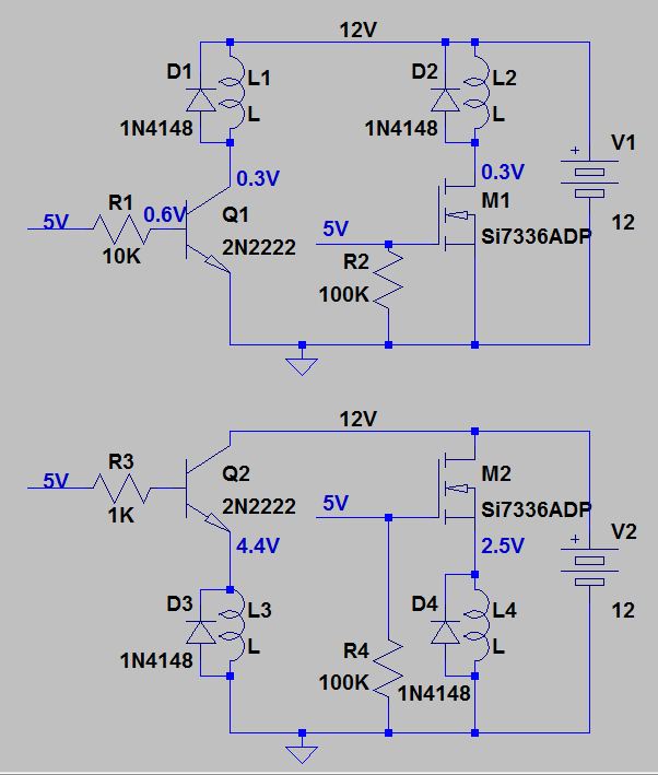

A picture = 1000 words.
Normally there should be a diode across a relay coil to protect the transistor.
The top two transistor are done correct.
The bottom two transistors do not work right. The voltage across the relay coil is small.
RonSimpson has a beautiful diagram. I always think of the NPN or N-Mosfet as a "switch to ground". That helps me remember which way to connect these. These top two designs work well with NPN or N Channel interfaced to digital logic (5V max).
You could do the bottom two relay designs, but with PNP or P Channel devices. However, to trigger those types, you may need more than 5V on the Base/Gate, making it much more difficult to interface with digital logic devices (like PIC or Arduino). That is why PNP or P Channel are seldom used directly with digital interfaces (but one can get driver chips for those to make more complex interfaces).
Stick with the NPN or N Channel devices, they can do almost anything you want. The 2N7000 are very cheap to buy, I use those by the dozens for low level interfacing. For larger loads, I use things like IRL530N Mosfets, the "L" meaning full on resistance at "Logic levels".
Thanks for the photo.
I always put a diode across the coil.
I have used those circuits many times but usually with a max supply of 5V.
I normally use which ever position upper/lower is convenient, but now I will take due consideration.
I've never used a 12v relay before.
I just couldn't understand why one position worked and the other not, but the explanation by Les Jones fixed that.
Like most magic, it's obvious when you know how it's done!
Now I can say that the bottom 2 will work with a device that needs less than 4.3v like an LED.
