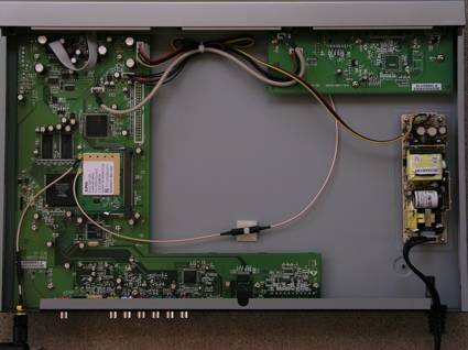

I've got a media player from the US, but am now in Europe. The player is wired for the US (picture of the open box attached).
Question number 1. Is it possible to replace this 110V part to 220V one (would that be called converter? - on the right side of the picture where the power comes)?
Question number 2. Where can I get one? And if anyody knows how it is called in French, merci!
And Question number 3. Is it an easy job for an amateur?

It might be able to work on 220V but the picture is too small to see.
What does it say in the manual; is the voltage rating written on the device?
The chances are if it's rated for 110V only you can't easilly replace the converter.
What's the power rating?
You can buy small auto-transformers that convert 220V to 110V in order to run US appliances in the Europe.
I am fairly sure that the power supply is a switch mode one. The main transformer is far too small for it to be a linear one.
Just about all the switch mode supplies that I have seen are rated to anywhere between 100 - 240 V, as it is easy to do and it makes commercial sense to have one design. All laptop supplies are like that, and they look like that power supply once you remove the black plastic.
I suggest you unplug the output of the power supply, and connect the power to 220 V. If it goes bang, you need a new power supply. If not, and the power supply output is at the right voltage, just plug it back in and you've saved yourself money and trouble.

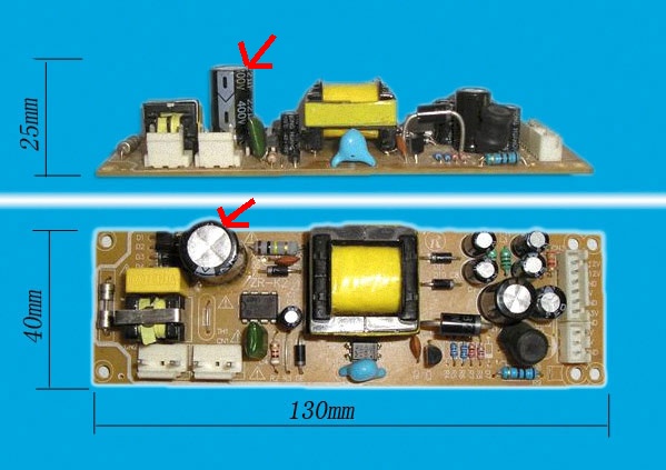

Have a look at the voltage rating on the biggest capacitor on the power supply. If it is 400V or more, the power supply is almost certain to be rated to 220 V.

Where is the 110-120V, 0.5A written? That isn't the capacitor value.
The big capacitor will have a voltage rating of 200 to 450 V, and a capacitance of 50 to 500 µF. Both these numbers will be written on it.
The picture show a typical power supply with the red arrows pointing at the big capacitor. The power supply on your media player will have a capacitor like that, and the numbers on it will give you a god idea of the voltage rating.

I agree, looking at the capacitor is the easiest way to determine the voltage rating.
The maximum AC voltage is normally equal to Vcapacitor/1.4, for example a supply 400V capacitor will a maximum voltage rating of 400/1.4 = 285V.
Even looking at the capacitor voltages, I think it's not a safe way to determine the PSU voltage rating.
Let's imagine a situation that the project engineer wants to have a "big tolerance", or a improved "resistance" to surges? But that's my opinion.
That's probably true to some extent.
A switcher with a 400V capacitor probably isn't safe working from 285V continuously.
On the other hand, I doubt an engineer would select a 400V capacitor for an SMPs only desinged to work from 120V.
A 400V capacitor is a good indication it's designed to work up to 250VAC and not just 120VAC.
The AC/DC power supply shown looks just like a Condor....and if you read the small white label on it you will see the input voltage range.
I would bet you a beer that it says 90VAC - 240VAC.
The unit is specified for 115VAC, because the input wiring is only compatible with 115VAC, and was probably made just for the American market.
Look again, and tell us what the small white label on the power supply says.
You could also swap it out with a universal input supply.....much cheaper than getting a step down transformer.
Get us the part number and manyfacturer name on the supply, this sould be easy to solve without resorting to a step down transformer.

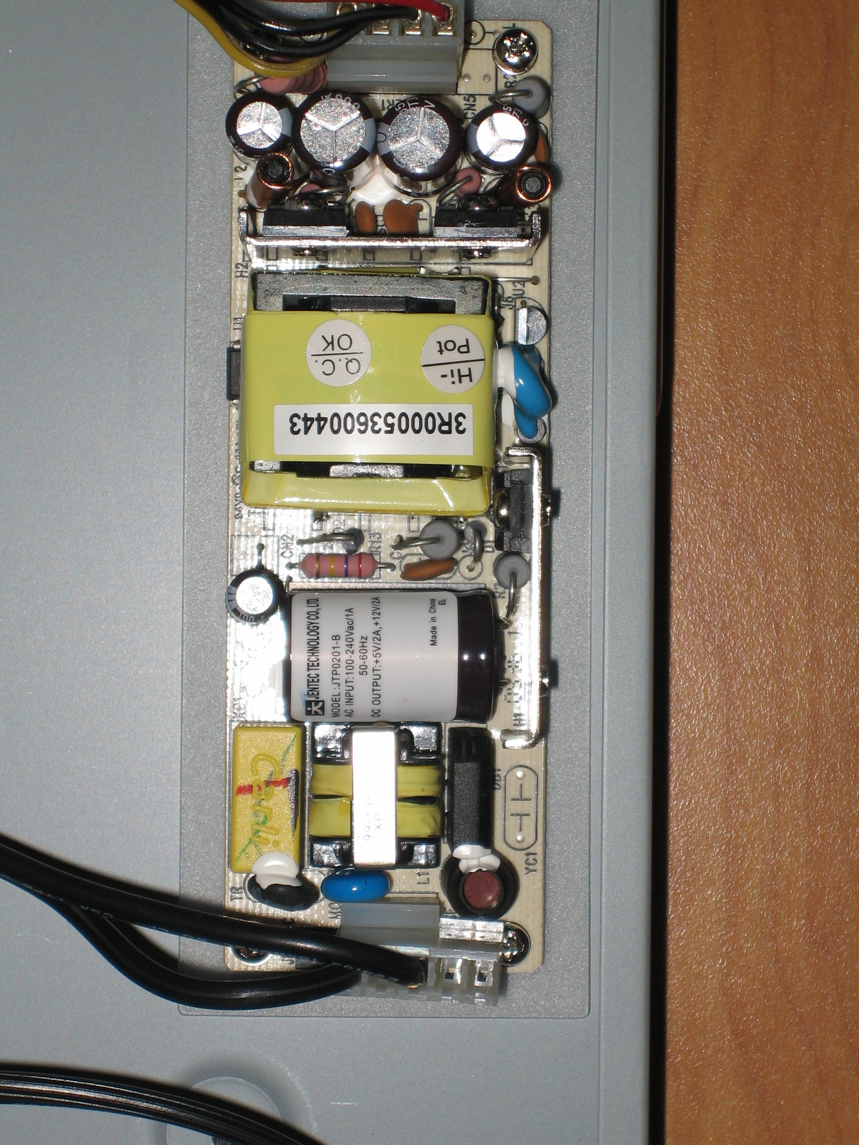

Here is detailed information
Hello again and I am certainly impressed with your advices. Sorry for a late-night reply, the weather was pretty good today and I happen to be now close by Alps, so couldn't resist putting my ski gear on.
You are giving me a lot of hope, however I haven't yet plugged the machine to my 220V outlet.
I am not sure if 1.3mb picture will upload, so this is what's written on the white label of a fat drum that you, I guess, call a capacitor :)
Jentec Technology, Inc
Model: JTP0201-B
AC Input: 100-240 Vac/1A
50-60 Hz
DC Output: +5V/2A, +12V/2A
Made in China
EL
I look for your concensus on whether I can go ahead and cut the US plug, screw on a EU plug and ... let it work.
thanks again in advance! always nice talking to the experts

Ooooo.. forget it. Your label clearly states 110 to 240VAC, you may cut the plug and put you ski gear back on :)

There you go!......just change the plug and you will be good to go!
