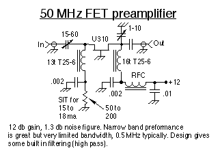

actually i want to construct the following circuit with small modification.
for 28Mhz rfc choke is 10uH.
in the diagram other coils are wounded on T25-6 toroid. is it critical?

adnan012 said:
thanks
Yes, it is critical. If you make your own coils with other type of toroid or some other core, you will have to tune the number of turns.
it means that inductance is important. specified inductane for 20 turns on t-25-6 troid is 1.02 henry.
problem is that i don't have toroids. can i make coil by using tune able slug former with same inductance?
Yes, but then you'll have to shield the two "T25-6" coils from each other and the outside world as toroids are self shielding. You can turn the two coils 90 degrees to each other to minimize coupling. RF projects need a shielded enclosure anyway.
