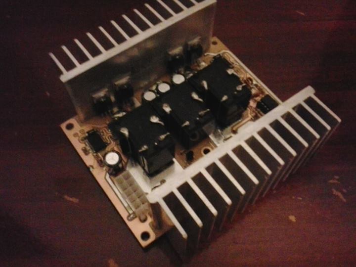

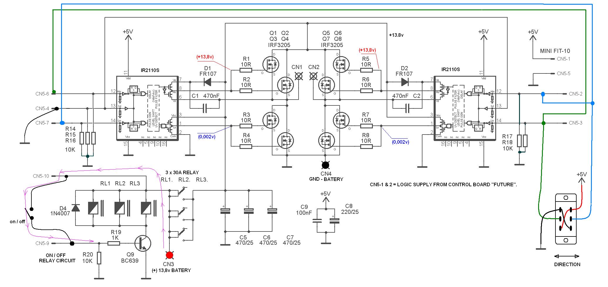

In this moment I have one "BOMB" in my hands! I assembled one (H_BRIDGE) to
control one motor in "13,8v" for a little electric car but, this circuit not work.
I'm probably doing it wrong ... During testing ... See the circuit used in the figure below ...
On the future this circuit will be drived with logic board based in one PIC microcontroller but in this moment I be testing with common switches...
I never used the IC "IR2110S", and do not know if this can be triggered only by reversing the levels in their inputs or pulses is necessary to make the engine run and reverse...!?
When I turn on the circuit, the voltage levels on the outputs of the drivers do not change.
And if I try to reverse the direction... The transistors begin to heat up ...
Have tested the transistors because I thought it could have killed them, however, nothing it's all ok.
Also replacing the two IC drivers however, nothing work ...
Someone has set up a circuit with this IC? Could give me some information?

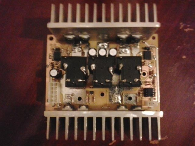

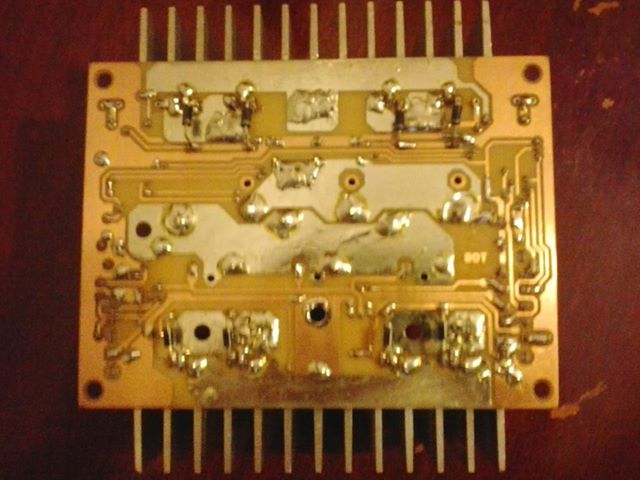

This is a first prototype board...
Wow, where to start! There are many problems in your circuit.
1. You have what is called shoot through (a short circuit) in you H-bridge the way its drawn. The IR2110, should turn on the top mosfet on one side of the H-bridge and the lower mosfet on the other side. Not both both top and bottom on the same side. When both top and bottom of the same side are on it is a short circuit/shoot through/bad.
2. Why are the control signals to the IR2110 drivers connected to ground through resistors (R14 - 14 - 16 - 17 - 18)? This doesn't allow the control signals to function.
3. You have no flywheel diodes on the H-bridge/motor connections. Very important on inductive/motor loads.
To maybe help you, here is a good link on understanding H-bridges. His whole website may help you, take some time and read it. http://www.mcmanis.com/chuck/Robotics/tutorial/h-bridge/index.html
I don't see whats wrong
No shoot trough. The switch is a break before make and will solve that problem.
It functions just fine. When the switch is up one side on high and the other is low. When the switch is down the MOSFETs reverse. For that brief moment when the switch is in between the resistors turn off all MOSFETs. No shoot through.
There are diodes in the MOSFETS. Maybe not the best but diodes. It looks like the switch will only be switch by hand so not very often. It it was switched 40000 times a second I could want good diodes, but by hand....we don't need good diodes.

I now know something:
1) The way the diagram is; one bottom FET should be on and the other must be off. He shows both bottom FETs have 0.002V gate to source. This can't happen.
A) CN5-4 might be wrong. It it was +5V then this could happen.
B) CN5-6 to CN5-3 and CN5-7 to CN5-2 might be wrong. If 6 to 2 and 7 to 3 this could happen.
C) The supply voltage is less than 10 volts.
D) Maybe FETs and drivers are damaged.
Please check 1A, 1B and 1C.
2)Design error: This works with a PWM but not with a switch. I should have seen this by post #3. Sorry!!
How the IR2110 works.
A) The bottom FET driver works very simple. Input is 0 or 5V and the output is 0 or 12V. Very simple. Power comes form pin 3. If this voltage is less than 10V it will not function.
B) The top FET driver is not simple. When working right the input is 0 or 5V and the output is 0 and 11 volts above the top FET's source.
Power does not come form the 13.8 supply directly. It comes from D1,2 WHEN THE BOTTOM MOSFET IS ON AND THE TOP MOSFET IS OFF. The output of the bridge must be at ground hard! Current flows through D1,2 and charges up C1,2. Then the top MOSFET is on and the bottom one is off, the bottom of C1,2 is up at 13.8 volts. The top of C1,2 is at 25V (about). The driver uses the power stored in C1,2 to work from. The driver uses 150uA and will in time discharge the capacitor and the top MOSFET will not get good gate drive and heat up. I think the driver should stop working at 10V across C1,2. BIG POINT: There must be switching (on/off at 10khz or higher) so that C1,2 have voltage stored in them. If a switch is used C1,2 can not charge up through D1,D2. The top MOSFETs can not be turned on for more than 10mS.
I should have seen that! I spent too much time saying 'there is a switch, no pwm' and did not think about what happens at D.C.
100A continuous is still over stressing this design. The mosfet rating of 110A is a little deceptive. That is based on a calculation only using junction temp. You need to read the footnote to that rating (#5):
At best, you get 75A. But even that needs a good heatsink. Also, the IR datasheet I just looked at said 8 mOhm Rds(on), which goes up with junction temperature. At 100A and the max junction temp, you have more than 1 V drop (>100W). So, 100A per mosfet is way over driving it.
I suggest the OP stay to 50A or a little more per mosfet. In other words, two or three of these IRF3205 mosfets in parallel for each leg should work with a good heat sink.

Well, the voltages on the concector "CN5" are:
1 = (+5v) logical, from microcontroller board " NOT EXISTENT NOW".
2 = (Hin 1) connected in (Lin 2) with wire-up for test...
3 = (Lin 1) connected in (Hin 2) with wire-up too...
4 = (SD1 and SD2) shoot down pin IC1 and IC2, put in gnd level for test...
5 = (GND) logical, from microcontroller board " NOT EXISTENT NOW".
6 = (Hin 2)...
7 = (Lin 2)...
8 = (OUT I -Sense) Future current sensor... NOT Implemented now.
9 = (ON/OFF) Return to activate 30A relays.
10 = (OUT +BAT) Used to connect switch ON / OFF to 30A relays...
This mode, I have connected the BATTERY (+ and -), ON/OFF power switch, (+5v and gnd) logical from bench power supply (test) and finally the HH switch for reversal test...
The pins Hin and Lin inversely connected , have your logical levels reversed acting in the test switch (H-H).
In this moment, the right side :mad:not :mad: respond with reverse of test switch (H-H).
But, the left side is OK:D... When the logic level on the inputs is changed, the outputs (Ho and Lo) is changed too.
I don't put FAST DIODES under the IRFs transistors to reduce the size of board.:p
The reason for the three relays is that the circuit under test already consumed (90A) """;) peak ;) """ ... And one commun switch would be too large ... With this argument, I use a small switch in (ON/OFF) circuit ...
My programmer friend "Rubens" make programming the logic part ...
For me, is left to do all the physical "hardware" ...
The control board will provide logic control for H-Bridge and PWM... Respecting all timing necessary...
In this moment I need to know if it is possible to connect the circuit according to the scheme for testing rotating and reversing?
Just changing the logic levels at the inputs?
Or will I need pulsing signals in these entries?
Again, thanks for your attention, sorry a little explanation for the circuit.

30A that is good to know.
I think the IR2110 can not turn on the top MOSFETs for a long time. (>10mS) So the switch is a bad idea. There must be PWM for the top driver to work. See post #13.
For testing you can remove the motor and use a car light bulb. Use a head light for high current. Set the duty cycle for 50% and look at the results.
You recommended to then change the logic levels at the bottom of the (H) bridge.
And the top of the bridge with the pulses (PWM)?!:eek:
You need a driver with a charge pump so they can stay on all the time.
Look at the HIP4060. Then you can either buy one or build a charge pump for the 2110.
