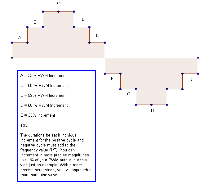

I would use PWM and increment every time, gradually getting larger in magnitude as you increase the frequency, then lowering the magnitude as you decrease in frequency (positive cycle); do the same for the negative cycle. You can imagine it like small steps up and down a sine wave, then you can use a filter to smooth it out.
I didn't know you could do that with pwm.
Your description doesn't quite make sense. Increment what? Change the magnitude of what? Please check your terms...
Perhaps a diagram will advocate my message more clearly.
Mike, K8LH is right about the need to experiment. He also nailed the answer to the question.
EN I can not make much sense of your post. Why would one be increasing the PWM freq, it is the duty cycle that sets the on off ratio which is converted to a voltage by the RC filter ?
That was my point. He really needs to work on terms. He may understand the concept but he's not conveying it.
In his new graphic for example, point 'C' should be 100% duty cycle and point 'H' should be 0% duty cycle. And without a reference on the X axis one might assume his transitions are occurring at regular intervals which would produce a sawtooth wave instead of a sine wave, that is if you can imply that "pwm increment" is actually "duty cycle".
Shoddy terms followed up with a shoddy graphic which includes more shoddy terms.
