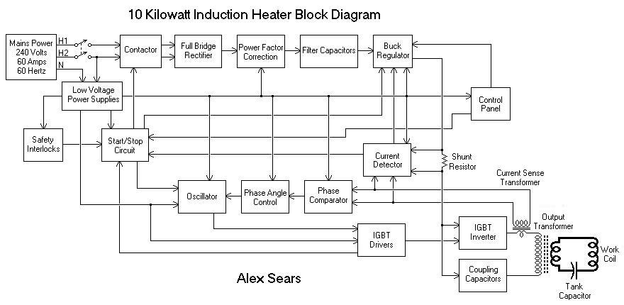

Hello Everyone,
I have started this thread to post schematics, pictures, block diagrams and questions regarding my 10,000 watt induction heater project. I will outline most of the major components of the circuit and describe their function.
So, lets start with the power supply, I have a 240VAC, 60 Ampere line (14.4kVA). This is then passed through soft start resistors to charge the filter capacitors and prevent a massive current surge from tripping fail safes. Since a bridge rectifier distorts the current waveform I have included an active power factor correction circuit. I have chose to limit the output power by varying the DC inverter supply voltage. To do this I have placed a buck regulator on the ~400VDC output of my PFC pre-regulator. The buck regulator will give me control of the output power from 0 to 10,000 watts.
On to the frequency control circuitry, the two inputs are from a current transformer and the high side oscillator. They are compared by a type II phase detector and filtered by an RC network. As you can see it is essentially a phase locked loop that keeps the oscillator (a TL494) on the resonant frequency of the series resonant tank which can vary with loading. I also have control over the phase angle to keep the power factor low (as close to 1 as possible).
The IGBTs in my half bridge inverter are driven by a pair of identical IGBT drivers that consist of optically coupled TC4422 IGBT driver ICs, undervoltage lockout, and antisaturation detection circuits. Both the high and low side IGBT drivers are coupled to the oscillator with optocouplers for equal timing. The antisaturation detection circuits compare the IGBT collector voltage to a reference voltage and will give a high output if the collector and gate are both high at the same time.
My current detector provides feedback to the buck regulator to limit output power if the current becomes too high. This circuit will also trip an overcurrent latch if the current is high enough to indicate a fault.
I have also included safety interlocks since I am building a commercial model induction heater. They cover things such as cooling water and component temperatures.
The IGBT drivers drive a half bridge of IGBTs that turn the ~400VDC output of the power supply into high frequency AC (about 20 kHz). The inverter output supplies the primary of a ferrite transformer with a 10:1 turns ratio. The secondary is stepped down in voltage and isolated from the mains. The secondary supplies AC to a series resonant LC circuit, I opted to use series resonance after discussions with **broken link removed**. He told me that the capacitor in a parallel resonant circuit will periodically short circuit the inverter during switching, but in series switching is better.
I have covered most of the important components of this induction heater, questions, comments, suggestions are welcome.

Well, right now I am in the process of designing the power supply, I was wondering how much filter capacitance would be required. The supply is 240V RMS which is then passed through my PFC pre-regulator that outputs ~400VDC the inverter will draw 50A RMS. The first filter capacitor will have to be the biggest because it has to smooth out 120Hz, the one after the buck regulator will be smaller since it operates at >50kHz. I will also place some smaller polypropylene capacitors at the output of the buck regulator for high frequency filtering.
The amount of capacitance required depends upon the amount of ripple voltage you can tolerate.
Would it be possible to operate the unit from 3-phase power? That greatly reduces the rectifier output ripple and also the amount of filter capacitance required for a given ripple.
I would if I could, it's too bad that I can't get 3ph at my house in the suburbs. I will be using the inverter current feedback to keep the frequency on resonance so I don't think that my control circuit can handle much ripple. On the other hand I may be able to filter it out with a high pass filter network and be able to use less filter capacitance. I will need to use high voltage capacitors due to the ~400VDC output from the PFC pre-regulator.

In the larger inverter based welders and plasma cutters that are single phase compatible the most common capacitance to current standard falls between 200 uf and 600 uf per amp.
So if your power supply draws around 50 amps at 240 volts AC a capacitor bank in the 450 volt 10,000 to 30,000 uf range may be sufficient.
Emphasis on the BANK setup. Preferably around 6 to 12 smaller capacitors in parallel is most common and gives the greatest service life.

I have already constructed a 1kw heater about a week ago. I had about 1000 watts RMS of inverter output 15 amps peak, 10 amps RMS, 106 volts RMS, PF >.9 all in all, pretty efficent. The major design flaw was that the transformer was only rated for 2 amps RMS max, I only ran the heater for about 30 second pulses and allowed the transformer about half an hour to cool between uses. I did not operate it from the mains because the setup was not really well insulated on my table and I did not want to get electrocuted. I have been able to heat a hardened steel screwdriver bit for an electric drill to bright orange in that time though. I have experience with switching electronics but I appreciate you concern.

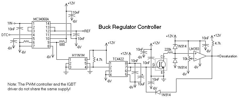

I have finished the buck regulator controller schematic. I used an MC34060A PWM controller, it covers 0% - 100% so I have full control over the output power. I have optocoupled the gate driver section to the PWM controller because I will use a floating supply for the gate driver for the same reason one would be used for a high side gate driver. I have not labelled the RC timing components on the PWM section because I want to determine the best operating frequency once I choose some other dependent components; inductor, transistor, etc.

The operating frequency is also dependent on the actual target. Higher generally being better.
Yes, also I dont want a massive expensive inductor but I want to be able to use IGBTs.
