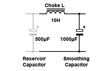

yes I did a whole set of experiments with diferent types of capacitors. I tried filtering with parallel 2200uF capacitor directly to the 5V line, smaller 1, 10 and 100nF capacitors and even an lc filter like this:
Didn't notice any change... Even tried to power the sensors and I2C 1Wire bridge with an external lm7905. Nothing worked.
