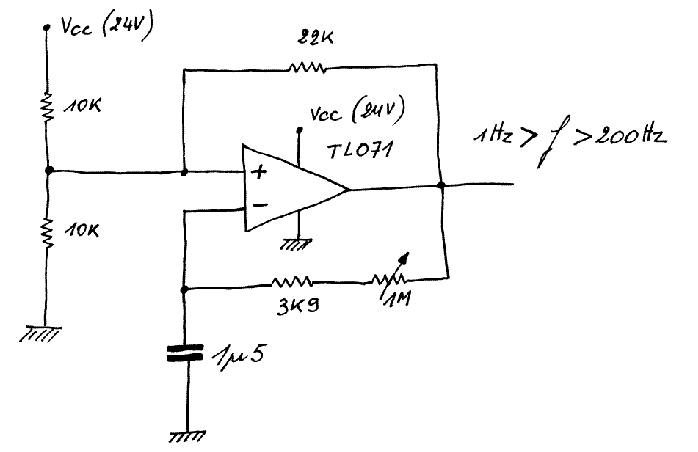

I need to make up an adjustable 1 to 200 Hz square wave signal generator, current sink output, to test a PLC I'm having some issues with. The system is 24 volt DC. Any ideas where to look for a circuit would be much appreciated.

Hi Phyxit,
Here's another one for you, not as fancy as the Jameco
thing but it should work equally well. If the logical zero isn't
low enough you can always add a transistor or a fet to
drive the plc.
on1aag.
