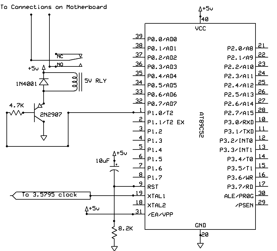

I was wondering how to generate a 1 second negative pulse that would turn on a relay I am using to power up a remote PC. (relay joins two wires for one second, then disconnects)
I have successfully done this with a microcontroller (89C52),a relay and a 2N2907. The relay is only connected for 1 second, then disconnected, using a delay loop within the microcontroller code.
I feel this is overkill and I am looking for an easier way to do this without the microcontroller.

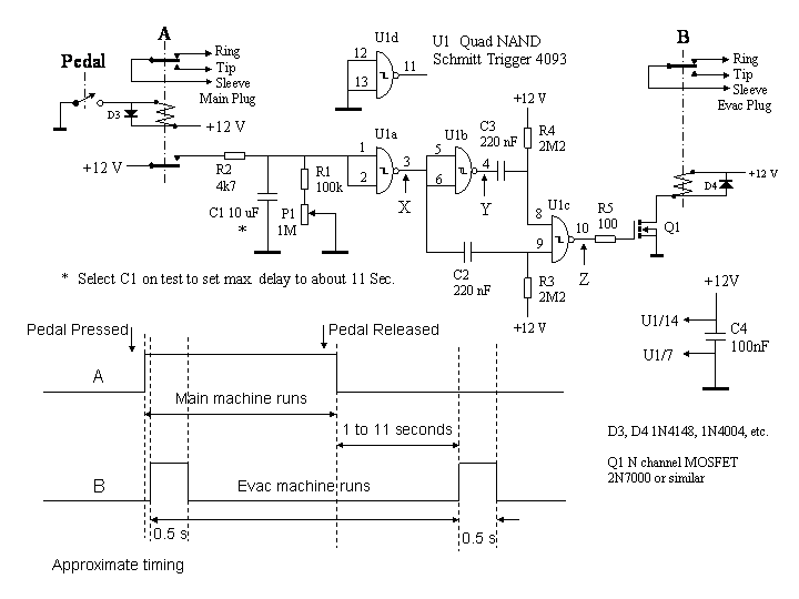

I designed this for someone recently. It does more than what you want but can be easily adapted.

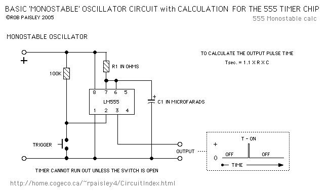

I found this circuit. This should be what I am looking for.
Thanks to everyone for your help.

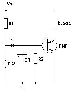

Here's a raw circuit that might do the job.
The PNP transistor is normally off due to the positive current at its base. When the normally open switch is closed, Capacitor C1 discharges through R2, and the tranisistor is turned on, activating the relay (RLoad).
I'll leave it to you to determine the RC time components that suit your purpose.

The capacitor and resistor value in the circuit I posted needs to be changed to 100uF and 10K. This will give a one second pulse.

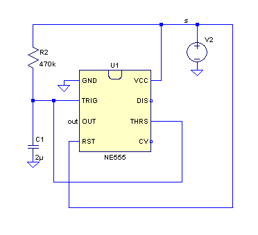

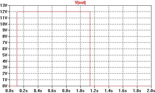

My solution: a self-triggered monostable with an NE555, a resistors, a capacitor (or two 1uF polyester caps in parallel). On power-up it produces a 1 second pulse (high). You need a current limiting reistor between the output and the base of the transistor. I used 12 V because I didn't know the voltage from your timer.

Thank you AllVol that circuit works perfectly. Extremely simple, hardly any components, best of all NO 555 timer and no microcontroller. I eliminated the switch, and for R1 I used 100K (hope that is ok) The circuit just powers up and turns on the transistor for almost 1 second, then it stays off. PERFECT!
I used a pot to determine what R2 would be. Best results are R2 = 30K and C1 100uF.
Is there a formula where I can determine the values of C1 & R2?
Many thanks,
JS
johnsmith123 said:
Thank you AllVol that circuit works perfectly. Extremely simple, hardly any components, best of all NO 555 timer and no microcontroller. Many thanks,JS
Those were your specifications. Glad it worked. Good luck.
EDIT: You're pretty close. OR maybe I was. In the original design, I guessed 47K for R2 and a 100uF cap. R1 is not critical.

AllVol said:
You're pretty close. OR maybe I was. In the original design, I guessed 47K for R2 and a 100uF cap.[/I]
In the end I changed the capacitor to 220uF because the 100uF cap gave a pulse that was too narrow. The pulse is now about 1/2 second and it works perfectly.
