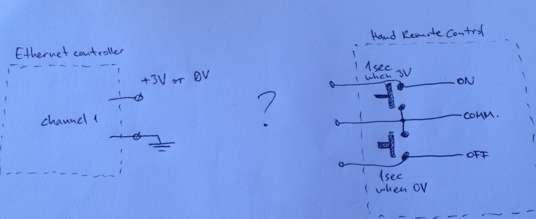

Hi guys,
I have a Ethernet controller which I can control to switch on or off different channels.
When a channel is ON, it gives 3V constantly on the respective exit. When OFF - 0V constantly.
I want to wire it to a hand remote control, which switch radio receivers in order to remotely operate bulbs for example.
The remote control has buttons for ON OFF each receiver. They should be pressed momentarily.
The ON and OFF buttons on the remote have common wire and the other end connects to the ON or OFF wire respectively.
What I need to build is a circuit that connects the common wire of a button to the ON wire for a second when 3V, and to the OFF wire for a second when 0V at the exit of the controller.
I imagine some circuit with transistors and/or with timer(s) 555 but I cannot produce it without help I am afraid. Any ideas? A! I don't want to use relays.

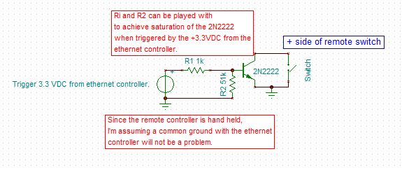

I've used many 2N2222 NPNs, with low voltage triggering, for low current manual switch interfacing, such as below:
As noted, R1 and R2 will need to be adjusted for your application to acheive saturation .
And, generally, grounding issues between a hand held, battery operated remote and another power source (such as the Ethernet device) are not a problem with a simple circuit like this.

Cowboybob, maybe I am now klowledgable enough but I can't see how tge transistor will switch the ON button for 1 second, and how the same transistor will switch the OFF button for 1 second. I need only 1 second switching because otherwise the remote would continiously send the RF signal to the receiver.
So, when 3.3v - switch for 1 sec button 1, when 0v - switch button 2 for 1 sec.
These 3.3 or 0v are constant signals.
Please see the buttons on the diagram at my first post.

What is special about 2N2222 for this application? Wouldn't any small-signal or switching NPN work as well?
Mike,
Nothing special about the 2N2222, except that they're just so readily available and cheap (and a very easy number to remember :D).

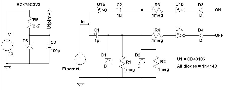

Something like this perhaps?
When the Ethernet output goes to 3.3V the OFF line is pulled low (to ground) for ~0.8 sec then reverts to high (3.3V).
When the Ethernet output goes to 0V the ON line is pulled low (to ground) for ~0.8 sec then reverts to high (3.3V).
This situation can be modified by reversing the polarity of diodes D3,D4 if required.
If the CD40106 output sink/source current is inadequate its outputs could be buffered.

Hi alec_t,
That's very very close to what I am after I guess.
The problem is I have some issues fully understanding it, e.g. what the D3 and D4 to connect to in order to trigger the buttons?
Why are the other diodes?
I think I need a bit different logic than the one described here...

The diodes are so that the lines which the buttons control can be pulled low (or high, depending on diode orientation) but allow for any internal pull-ups/downs internal to whatever the buttons control.

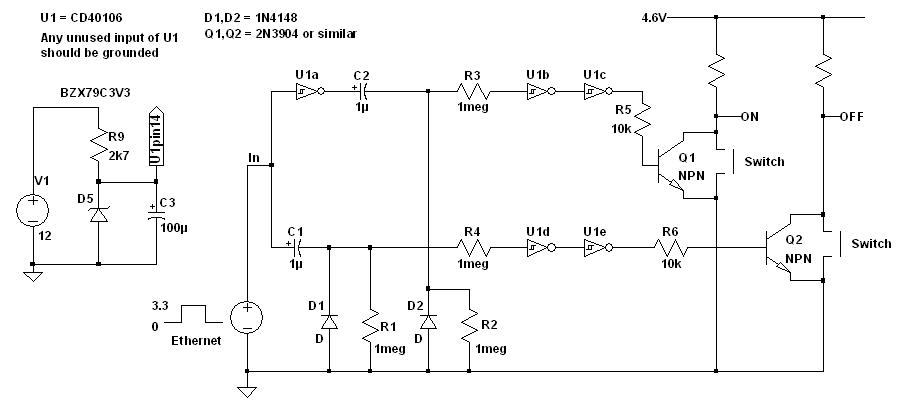

If I've understood you correctly then this revised circuit should do the trick:

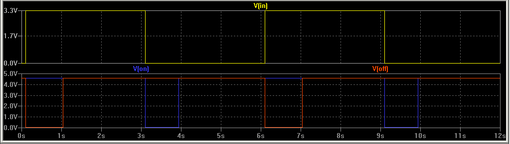

And here's a waveform plot:
alec_t - thank you so much!
It seems that will work. I will test it when I get the parts and post the results.
Could you be so kind to explain what the 1st, 2nd and 3rd inverters are doing exactly for the ON line and what the 1st and 2nd inverters are doing for the OFF line, e.g. how the signal changes (and the duration) after each inverter. I just follow hardly the waveform.
I am asking because I see too many invertors, but I cannot get why for? :)
Cheers!
The CMOS gates used have the advantage of an extremely high input resistance, so require negligible current to turn them on or off (unless switched rapidly), unlike BJT transistors. Thus they can be used as buffers. That means we can use smaller value capacitors and higher resistance values for our timing than would be needed for driving BJT transistors directly, and also means less loading of the Ethernet output. When 'In' goes high C1/R1 generate a positive pulse. This is inverted by U1d then inverted back again by U1e (because we didn't really want to invert the pulse; only buffer it) to switch Q2 on and hence make 'OFF' low. Similarly, U1b and U1c together act as a non-inverting buffer. However, we do use U1a as an inverter (as well as a buffer), so that when 'In' goes low U1a output goes high and C2/R2 generate a positive pulse which via buffer U1b/c turns on Q1 to make 'ON' low.

However, I think U1a should be on the OFF line and not on the ON line. The Ethernet signal will be high when button ON should be pressed and low when the OFF button should be pressed. But thats easy to change of course as this is the only difference between the two lines.
thanks again so much, I will post the results when i do the test.
You don't need to move U1a. Just swap the labels 'ON' and 'OFF' on the schematic :)

Just wanted to check again with you, these caps, why they are connected that way and not in paralell with the power?
I was expecting to see the R and C positions the opposite?
Also, what exactly the diodes are doing?
