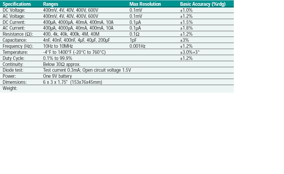

What's the manual for your meter say? It's going to give you a percent full scale error and non linearity percentage for each of the ranges. Keep in mind the resistors inside the meter itself are usually only 1% themselves. If you need to fine tune a resistor divider network to that extreme anyways you're going to want to use a trimmer pot.
Sceadwian said:
What's the manual for your meter say? If you need to fine tune a resistor divider network to that extreme anyways you're going to want to use a trimmer pot.

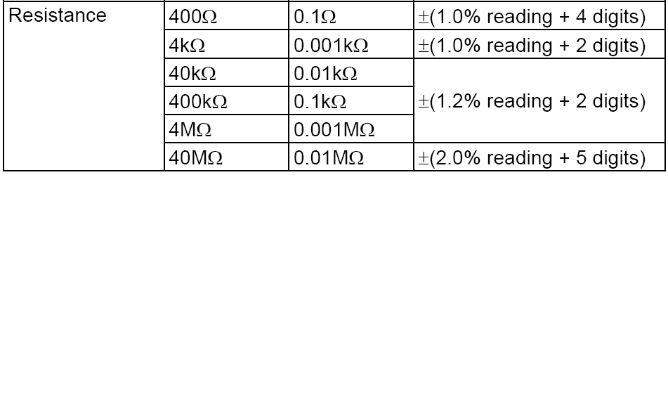

I didn't design the circuit, so I don't know to what extreme was intended, but I assume if they specify 1% components then that is the extreme. Even with the specs. of the meter the resistor is off by at least 200% of the advertised accuracy. I suspect however that the meter is not that far off and the supplied resistors are even further out of spec. Is it really that hard to believe ? Anyways the designer has responded in another thread that the resistors I have will indeed work, so I guess it did not need to be quite that precise.

Manual for what? As far as I'm concerned the meter is not in question. 50 resistors very well in spec. and 4 very far out of spec. The 50 I already had, the four came together with a kit. See the connection? The 4th and 5th bands are brown.
