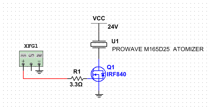

Hi everybody, I want to play a little bit with the 1.6Mhz atomizer from Prowave (https://es.farnell.com/prowave/m165d25/atomizador-ultras-nico-l-quido/dp/1007369). I would like to test its atomizing capability at first without implementing any difficult circuit. I was thinking using a basic circuit with just a mosfet amplyfing a square wave signal from a function generator, but it's not working. Do you know which is the reason?
Thanks!

You are missing a pull-down resistor across gate-to-ground to ensure the mosfet turns off at every cycle low ? The piezo is a capacitive load. It would not hurt to parallel a resistor to it, just in case.
I think your function generator cannot supply enough output current at about 10V p-p to drive the very high capacitance of the Mosfet gate at such a high radio frequency. But if it did then 24V power supply might collapse.
Welcome to ETO!
Since the transducer is, as Externet says, essentially a capacitor, your circuit will simply charge the capacitance up but not discharge it again: hence no oscillation. You need a push-pull drive for the transducer. Also, the transducer ideally should be driven at its natural resonant frequency, which will vary depending on its loading by water etc.

Duh. The Mosfet has no load, no wonder it does not drive the piezo transducer that is a capacitor.

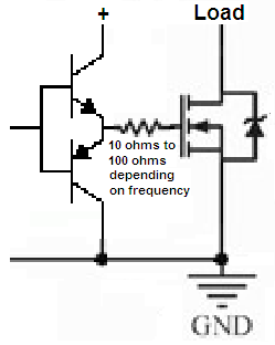

Wikipedia: "Because of their unipolar nature, the power MOSFET can switch at very high speed. Indeed, there is no need to remove minority carriers as with bipolar devices."
BUT they have a very high capacitance from gate to source and between drain to gate. The Miller Effect increases the apparent drain to gate capacitance which is negative feedback trying to cancel the switching.
Therefore a power Mosfet needs a high current push-pull driver to quickly charge and discharge the capacitances.

Many circuits use a complementary push-pull emitter followers driver like this:

The down side surely is you are going to limit the switch speed to that of the BJT driver? So in many cases apart from high power you might as well go with just a BJT? Sort of negates the advantage of higher switching frequencies of the MOSFET if you have to drive with a BJT
The BJT driver switches very fast. Ordinary little 2N4401 and 2N4403 transistors can supply hundreds of mA at very high frequencies so that power Mosfets are frequently used for low loss PWM switches.

European BC327 and BC337 transistor are almost the same as 2N4401 and 2N4403.
