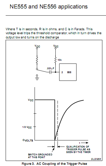

Look at this image of the required trigger pulse width.
If you want to 'convert' a 5mS pulse width into a 1.5mS, 'ac' couple the 5mS such that the 5mS pulse width is less than say, 1mSec.
If you need to, you can use the 555 RESET to hold off, the 555 while the power supply is stable, then apply the trig pulse. OK.?:)
The 555 ic is perfectly suitable for all engineering applications where a simple pulse is required.

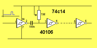

If your pulse is positive-going, just use Schmitt gates:

He is not detecting a threshold, but a period or duration of an incoming trigger pulse
If your pulse is positive-going, just use a Schmitt gates(s)
What has the polarity of the pulse to do with a using a Schmitt.?
Some of posts you are making are very misleading to any student who may not be aware of the inaccuracy.
"He is not detecting a threshold, but a period or duration of an incoming trigger pulse."
He is actually detecting a THRESHOLD (more accurately the presence of a signal or voltage of 5v or 12v) and producing a pulse of 1.5mS duration. The duration of the pulse does not matter. The circuit I have created produces an output of 1.5mS, no matter how long the input signal is present.
The poster had a problem with a positive going pulse, just as I did, using a 555. That's why I suggested using a Schmitt gate.
That is rubbish.
If you read his post, he wants to generate a 1.5mS PULSE from a 5mS trigger PULSE.... no mention of thresholds as I can see.
If he needs to invert the signal, all that is needed is a simple transistor invertor between the source and 555 trigger.

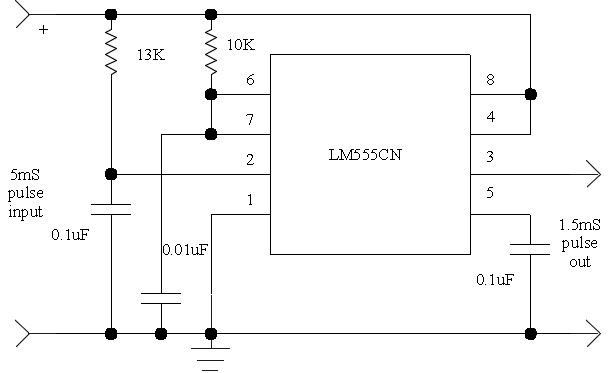

After reading the thread, I think I can help you. A 555 as a one-shot should do fine and I will be happy to post a schematic, but I need some more information.
You said the 5ms pulse is 9V. Is this pulse being generated from a 9V battery supply and do you have access to the 9V power leads?

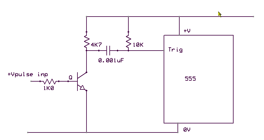

My main problem is triggering the 555 from a positive pulse to produce 1.5 ms pulse everytime the initial 5ms pulse triggers it.
I can do it with a negative trigger but not a positive one.

add a simple transistor invertor before the trigger circuit.
Its not a 'negative' trigger but a 'negative going' trigger.
Do you follow.??:)
EDIT:

Yep that looks like its what I'm after thanks alot, ill experiment with it and let you know how it went.

Here is a schematic that may work depending upon theenergy of the 5mS pulse. I used a comos 555 as a 5mS one shot from my function generator to trigger it. You will notice that the power for the 555 is also obtained from the 5mS pulse.
I have used this circuit on occasion with the input + terminal going to +Vcc. On power up it generates a short + trigger.
Correction: The two capacitors on pins 6&7 and pin 2 should be reversed. The .01uf should be on pin 2 and the 0.1uF should be on pins 6&7. And the 13K and the 10K should be exchanged.
