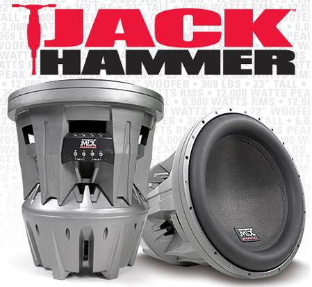

I won't get into the game of finding an amplifier with a very high power output.
But I found the MTX Jackhammer sub-woofer speaker. It is 22" in diameter, weighs 369 pounds and is rated at 6000W RMS.
Its cone moves 5" p-p.
