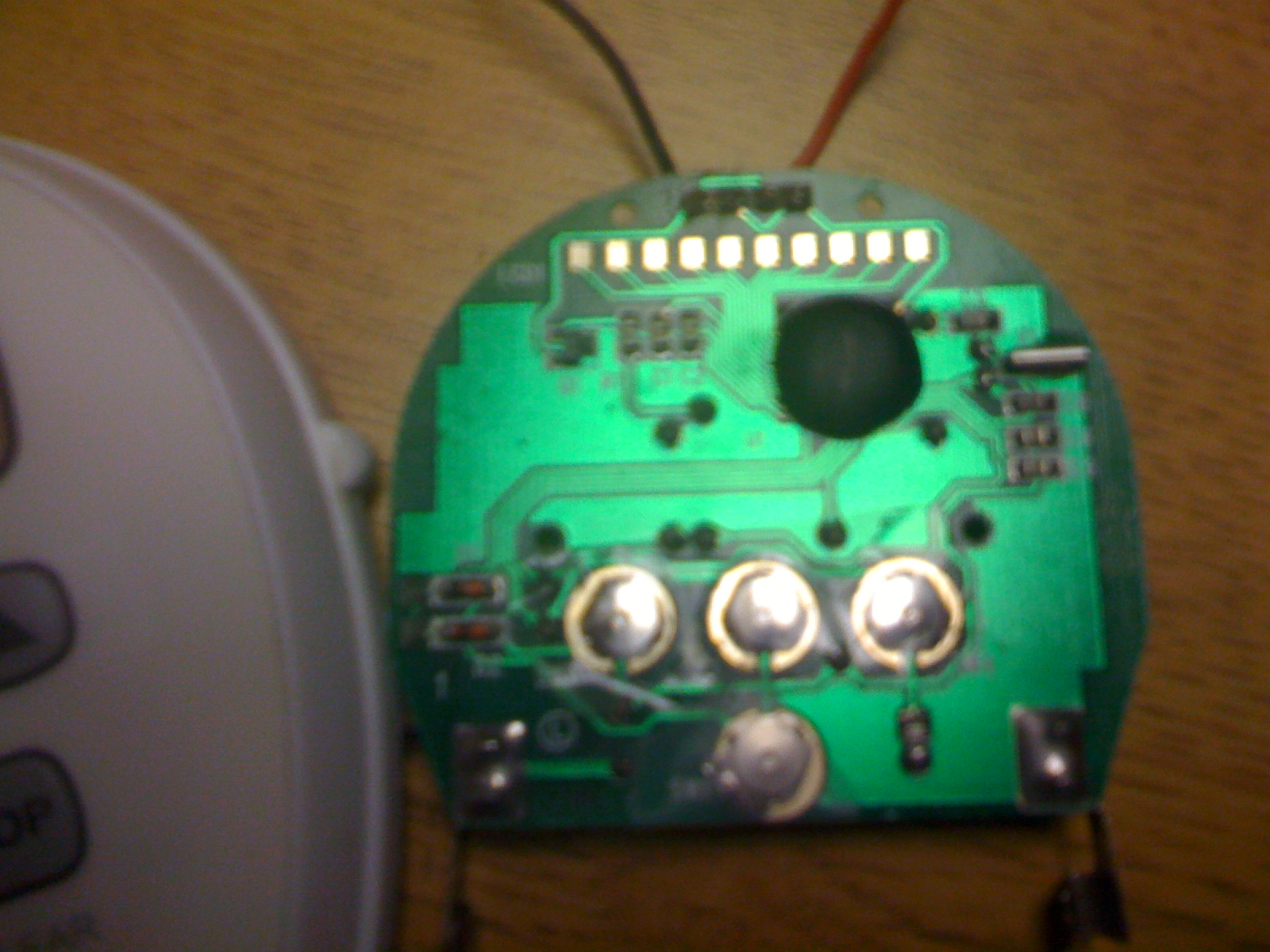

As I am sure several of you are apt to do, I intercepted this egg timer before my wife could throw it away. Lux brand ET50, unfortunately, I can't find any FCC id to lookup schematics.
The piezo buzzer stopped working, but the rest of the electronics seem to work well, and when attached to another buzzer, it works fine (I won't tell her that part, as I now have plans for it).
I plan to intercept the output to the piezo with a small PIC, which when the timer goes off, it will ground the shutter button on a canon SLR camera, and then trigger the reset button on the timer to start counting again.
The LCD, microcontroller, and buzzer all work off of a single 1.5 volt AAA battery. I don't see any MAX1674 or MAX7176 that would up convert to 5V, and I can't tell what the IC is without removing the black plug, which might also rip off the chip. I have tested with the voltmeter all around, and it is 1.5volt throughout. Which mictrocontroller do you think they are using at 1.5 volts.

It uses a chip on board - the die is mounted directly to the board and is covered with a black blob of resin.
It's not a microcontroller but a custom built low voltage CMOS IC.
This kind of construction is very common in clocks, watches, timers, calculators and electronic toys.

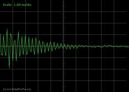

I should still be able to capture the PWM info that is sends to the piezo buzzer, and use a PIC to decode it, right?
The buzzer has no info on it, but putting the attached sound file (recorded from the buzzer going off), it appears to be about 3.5 peaks per ms, which if my math is correct, makes it about a 3.5 khz buzzer.
Should I then assume that what I need to set the PIC to capture is a 3.5khz signal length?

3.5kHz sounds fine, it's probably an electromagnetic buzzer but it could be piezo.
The reason why I suspect electromagnetic is more likely, is because it tends to be louder at lover voltages because it's lower impedance.
Why do you care about the frequency? Don't you just want to know when it's gone off? If there's a signal there at all, it means it's gone off, right?
The way the circuit is set up, when the pin on the CMOS goes off at the end of the cycle, it triggers the base of a NPN transistor to connect the collector, connected to the buzzer, to the emittor, connected to ground, in a pulsatile fashion that resonates the buzzer.
Yes, you are right, all I care about is that it goes off, but the CMOS uses such low voltage that my challenge has been to get the pic to read it. A comparator will probably work fine.
