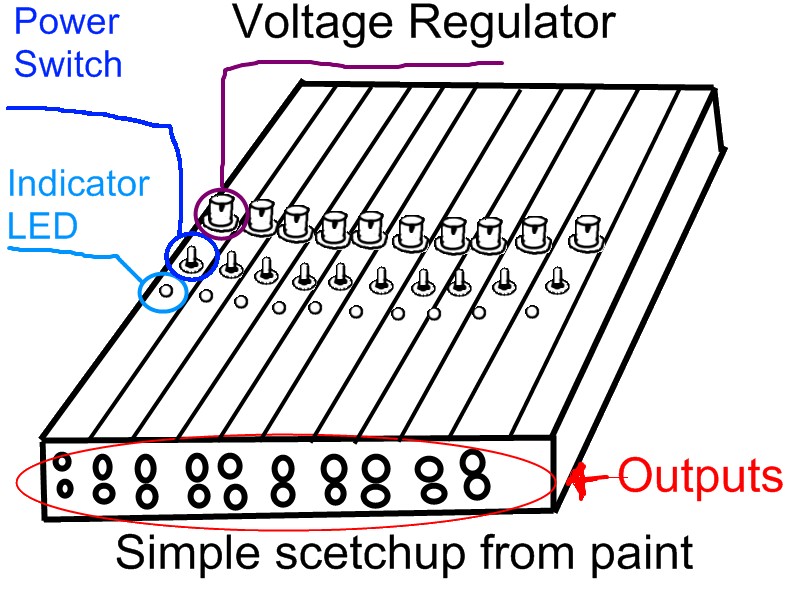

What I would like to make is a controller that has 20 + outputs of 0-5(9) VDC where each of the outputs can be adjusted from 0-5(9) VDC without interfering with the other outputs. I would also like each output to have a on/off switch.
Each output will be used to drive small motors (like the onces in CD-Roms) and the wire from the controller to the motor may be several meters long 0-10 meters.
Attached a illustrating Picture
A text diagram of how I want it to work
220-240VAC --->AC/DC transformer eks.**broken link removed**--->20+ different voltage regulators that can regulate the DC voltage from 0-5 and where each can be turned on/off--->20+ different outputs for motors eks. **broken link removed**

What I would like to ask is:
1. Are there anything that would be easy to modify into this, like computer power supplies and such things.
2. Is this project easy enough to make? ( I can solder and all that, just a little rusty on the electronics)
3. Anything else I should be wary about, like heat sensors for the motors and such?

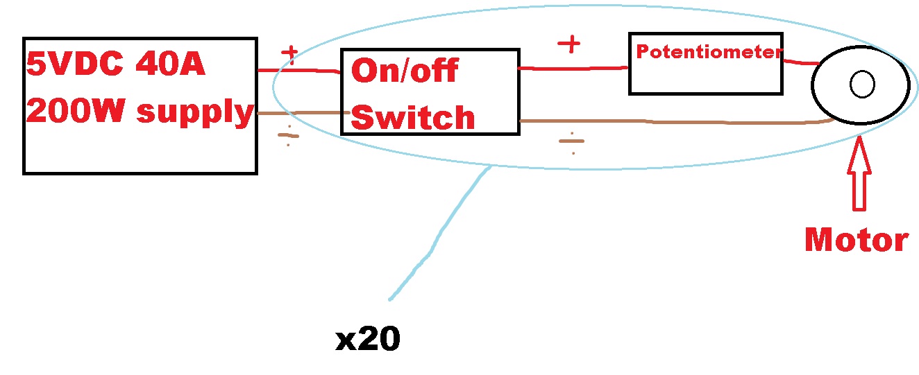

So is it possible to take a 5V 40A supply, and split that 5V into 20+ different motor controller circuits with on/off button + voltage regulator(with potentiometer so it can easily be operated) from 1,5-5
Would this be possible to do? as a way to get this thing to work and to regulate the voltage for the motors??. (see picture attachment)

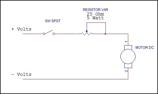

That would work. Simple and inexpensive. You really only need to switch the high sides of the motors with the pots in series. Something like the attached. You will need to mess around to get a pot that will work well but with 5 volts supplied about a 10 to 25 Ohm 5 Watt pot should work. Hard to tell what the little motors will actually draw will be.
Ron
