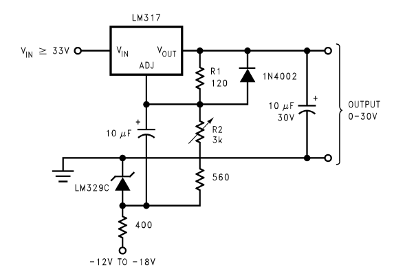

Another solution is to use a LM317 (Or LDO if the Vin-Vout is too small for the 317) but reference it to a regulated negative supply rail. Here is an example of this from the datasheet:
lm317-png.25614
There are probably better ways of supplying the -6.9V or whatever.

Another solution is to use a LM317 but reference it to a negative 1.25V supply rail. Here is an example of this from the datasheet:
lm317-png.25614
There are probably better ways of supplying the -1.25V.
I take it using a negative rail for the feedback resistive divider might also work for a switching converter? If that's the case, things could be made to generate much less heat. I'm just not sure if the feedback loops used in those get unstable if the output voltage is below the internal reference voltage inside the converter IC.
You'll struggle to get 1A at 10V with 12V in with an LM317.
Besides where are you going to get the negative rail from?

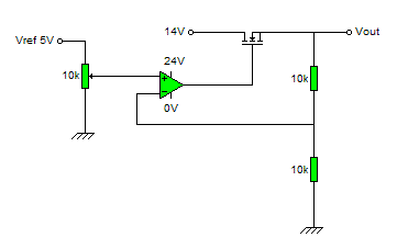

Have you seen LT3085? It is adjustable to zero volts. You will still need to get rid of a lot of heat if you want 1A at all voltages.
This will work but you'll need to supply the op-amp with a higher supply voltage; a voltage double such as a 555 circuit can do this.
You can use a p-channel MOSFET if you swap the + and - inputs to the op-amp but you'll need to add a 100nF capacitor from Vout to the -input, the dropout will be higher and it won't be so stable.
For 0V output, you also need to select an op-amp with inputs that work down to 0V, unless you want to add a negative supply.
This isn't current limited, current limiting can be added at the expense of a higher dropout or you can just add a fuse or PTC resistor (polyfuse/switch).
