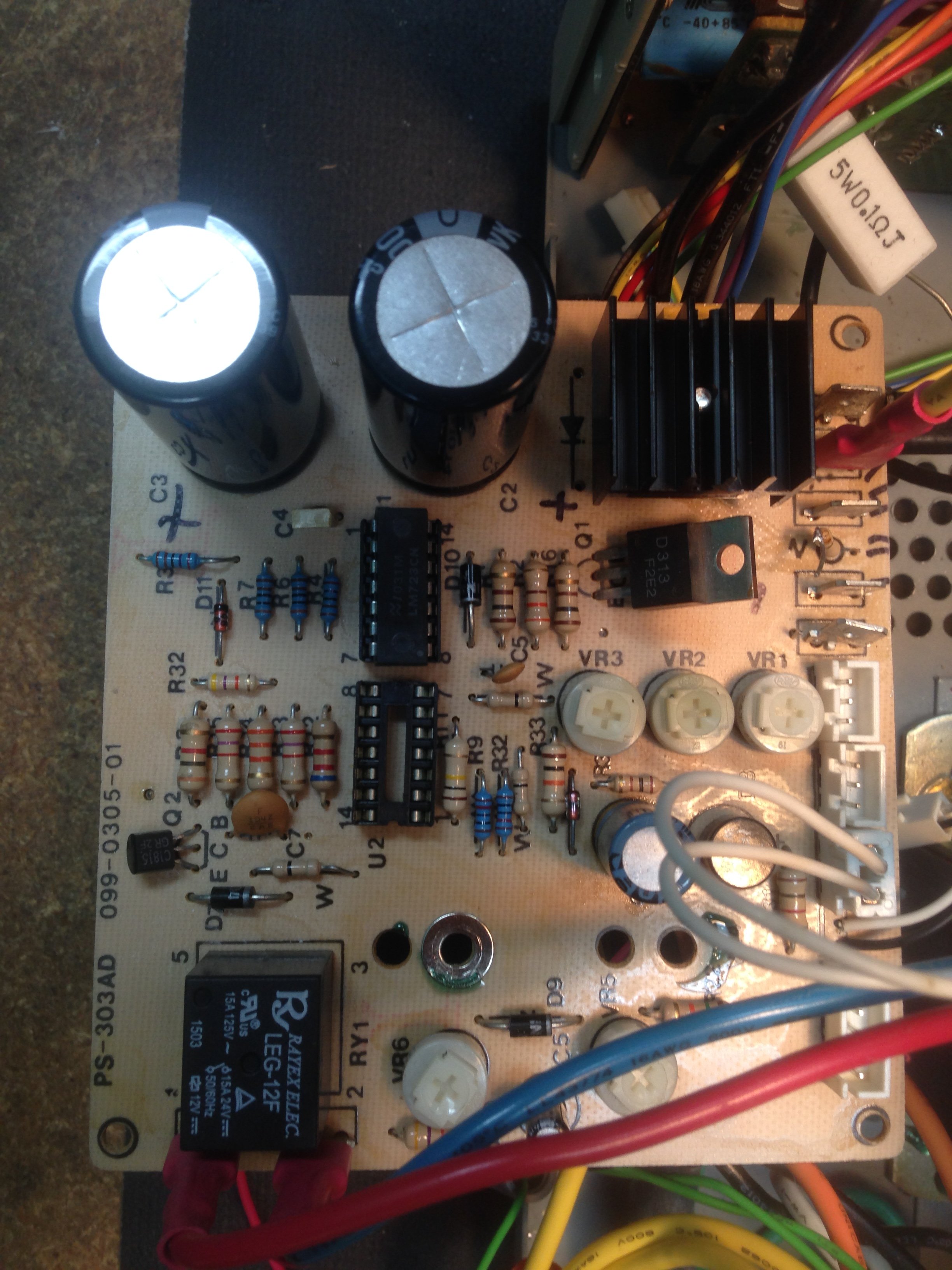

I am trying to repair a WP-775B, 0 to 30 volt power supply, made by Vector-VID. My main problem is IC2 (14 pin DIP) is missing. The circuit board layout strongly suggests it is a quad op amp, but I can’t find a schematic to identify which op amp it is. This IC feeds the analog current and voltage meters, so I’d like to be reasonably sure which op amp to use so I won’t ‘smoke’ the meters.
My 1st guess is a LM324 because 24 VDC is on pins 7 and 11 and the unit appears to be built around the 90s. Also IC1 is a LM723.
Any ideas or suggestions would be greatly appreciated.
I uploaded a couple of pictures. I'm also finding out that LM148s were common at this time

Hy gray5596,
The Vector-VID WP 755 Power Supply Unit (PSU) manual, including schematic and parts list, is attached below.
The component nomenclature appears to be different to your PSU, but I would think that the circuit principle is similar. At a guess I would think that there are two versions of this PSU: one with an LM723 voltage controller and one with an LM324. So it could be that the missing chip on your board is intentional.
Note that this PSU has a pre regulator using a phase angle controlled (I think) Silicon Controlled Rectifier (SCR) (SCR1) to maintain a roughly constant voltage drop across the linear series pass element (FET1) and thus limit the dissipation in the serial pass element.

Thanks!
My model is the 775B and doesn't have a SCR pre regulator. However your schematic shows a LM324 op amp and so it would be a safe guess that my model would also use the same op amp.
This information is what I was looking for, thanks again!

The missing IC was a LM324. After installing this op amp, repairing a burn trace and a few other components, it is working.
Instead of a SCR pre regulator, this has a high and low voltage output on the transformer that is controlled by a relay. A neat idea to keep the pass transistors from dissipating too much power.
