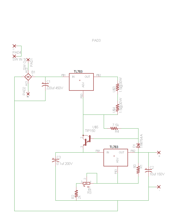

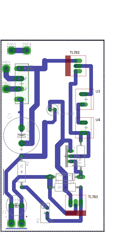

I'm currently designing a circuit which will require around 100VDC 400mA (exact voltage and amperage can vary a little). I've designed the circuit for the power supply, which will be separate from the main circuit for my project.

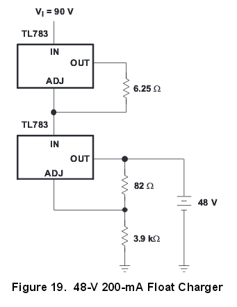

I've built the schematic to reflect what the suggested circuit should look like for my project on the IC (TL783) datasheet. The resistors following the first TL783 IC are 30W each on a TO-220 package (which will be on a heat sink just in case), so 40 watts of power shouldn't be a problem for them. The two pads at the top labeled SW in and SW out are for the wires which will connect to an external flip switch rated for 115AC mains voltage. The board needs to provide the proper output, + or - a few volts and mA, from 115V AC mains, and provide short circuit protection. If you look at the TL783 datasheet, you will see a few example circuits, two of which are being used in this design. When i test this board out, I'll be attaching the output to a 20ohm 100W resistor to simulate the load, as both the power supply and H-Bridge circuit will be sharing the same "on/off" switch, but through a relay to isolate the voltages. When I go to test this board for the first time, it will be connected to an AC isolation transformer. The board has ratsnests all connected to neutral to help isolate some of the emf that would probably result from operation of this circuit.

Here's what I want to know before actually ordering the parts and building the board:
1) Obviously, will this circuit work?
2) If not, does it short out?
3) Where is the fault located and what can I do to fix it?

Let me take one piece at a time.
1) Here is probably where you started. That 6.25 resistor is for 200mA so 3.1 ohm is for 400mA. From OUT to ADJ there is 1.25 volts. Your two (1.5 ohm 30 watt resistors are over kill) The 3 ohms is right. But the wattage will be low.
2) You need "connecting dots" where line connect.

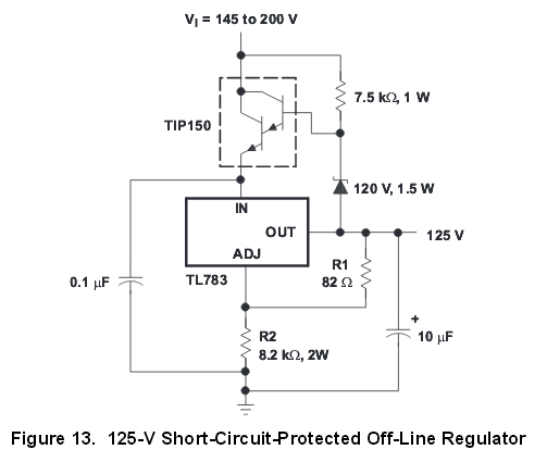

Then you used this to keep the voltage across the TL783 below 120 volts.
That works! BUT.
3) What happens when there is too much current and the top TL783 opens up and takes all the voltage? Does it also need "too much voltage protection"? I do not have time to think about it. BIG question.
4) There is a circuit with a diode from OUT to IN. Please do that if this is a "bench power supply".
A PSU connected directly to mains is a really bad idea. Do you realize that both the high and low side of that circuit will be a direct electrocution hazard as both the positive and negative rail will be at line potential?
Thank for the responses. The reason for this being a transformer-less psu is due to spacial constraints. Believe me, I do know the dangers of connecting directly to mains, and had i the option to do so i would have added a transformer. This supply, however, needs to be small, and must carry approximately 100v at 40W, and it is very tough to find such a psu that doesn't cost too much.
Thanks for the info, ronsimson and chemelec, I forgot about the higher voltage output of rectified AC voltage, and what would happen to the first TL783 since it can only output up to 125V. I was wondering if flipping the switches would solve the problem. The TL783 has a max output of 700mA, and the chip is more than capable of taking in higher voltages. So if I lowered the voltage first to an appropriate 100v output, the current limiting chip would be able to lower the amperage down to 400mA.
As for the comment about the wattage being low, I am not quite sure i understand you. It needs to be 40w +-10%, which is also why i have 2 30w resistors in series in the output: The entire output current would flow through them, therefore anything less than 40w may cause some heat issues.
so, do think switching the ic circuits would help? do you think i should replace the current sourcing limiter with a current sinking limiter circuit?
THe Cap is way too small.. 220uF * 20 Ω = 4.4ms or only 1/2 of the 8.3ms cycle.

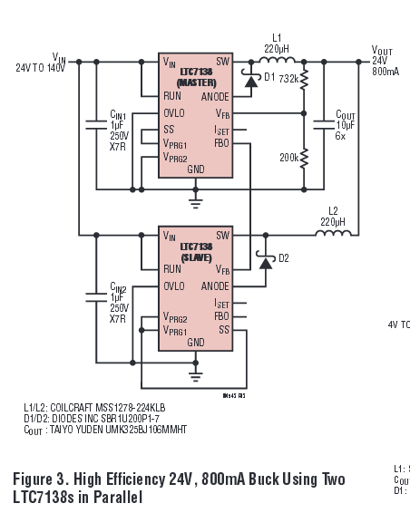

This switcher will not be hot and should survive a short with out heating. 90% efficient.
The circuit below is small. Remove the second IC for 400mA. Change the feedback resistors to get 100V out.
If you are interested in switching power I could work up something better.
  • LTC7138f.pdf

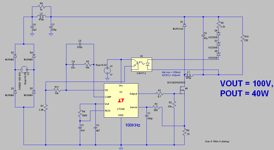

Do you have LT Spice? If so you could see this run.
100khz switcher. Probably will work up to 140VAC in.
I have not testes what happens at low line. Probably needs some work.
Regulation is not right yet. Need some work!
For the first shot it almost work.
There are some noise problems yet.
R10 250 ohms is the load.
I have to remove the 17 volt supply and probably remove the U2 before done.
I don't remember what the current limit is set to but I think 600mA.
The IC is 8 pin small. M1 is to-220 type.
I would also change the voltage rating in Cap C2 shown in the original drawing. It should be at least a 300v rated cap.

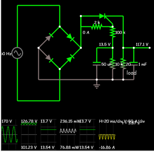

Forget a linear supply . You will need at least 1mF @>120V rating which cost $35 (1), more if driving LEDs without flicker. What is your actual load device?
Define your cost and volume targets and expected ripple V max.
For a series power resistor , if you were dead set using a linear supply, you can use some halogen bulbs in parallel with a 10A bridge and 1mF cap. Halogen R with 3~ 5 Ohms cold resistance, putting in series or parallel depending on voltage.
then you can use an adjustable 3 terminal regulator to drop from 110~130 to 100V
To prevent no load overvoltage, you need something to preload the supply when load is off otherwise it can go up to 170V.

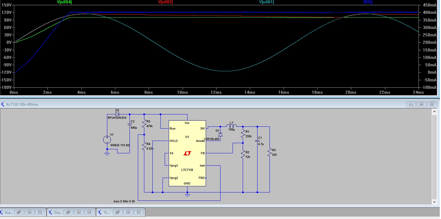

Ok, so i gave up on getting orcad and proteus to simulate my circuits correctly, so i decided to try ltspice and was able to get it working. I was even able to import a TL783 spice model into it and got it to work properly. There is one thing i am confused about. The rectified 115V AC input does not go anywhere near the projected 170VDC. Is this because i am only using a single phase AC line voltage, or is it just the way the simulator works?
That is because in spice a wave form is defined by its peak voltage not its RMS voltage.. So the line voltage is 160 volts.
Try this file. I changed to a "constant off time" PWM that is stable. I need to remove the 17V supply. I did that in another version and it works fine. (had to add some components)
You probably know. Push the "run" button. Then with the "probe" select nodes to watch. In the case of the output voltage that is not referenced to ground you want (node 2) - (node 10). The easy was is to either select node 2 and then in the "scope" change the formula by adding -node10. OR Put the prove on node 2, hold down the mouse button, move to node 10, release the button.

I ran the simulation and see what you mean. This should definitely help. I've also created this small power supply in LTspice using the LTC7138 you mentioned earlier, however instead of a rectifier bridge, I used a simple diode, since only one side will be ac when i plug it in (I will of course ensure that the plug is designed to be oriented a specific way to avoid reversing the polarity). Would this sort of supply work? or will the voltage still exceed 170VDC?
