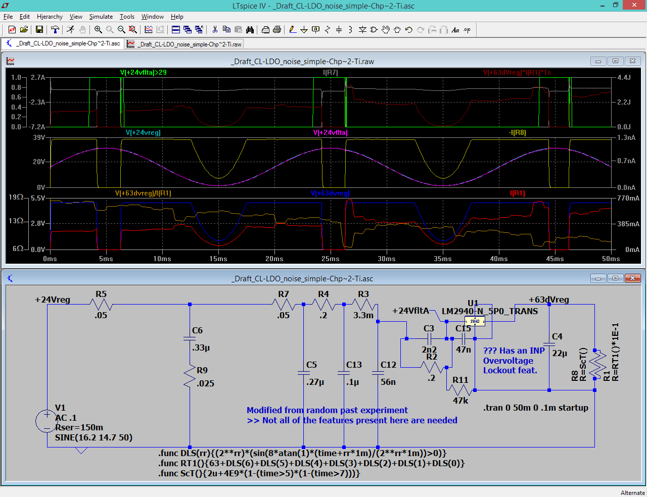

The datasheet for the LM2490 and for most other low dropout voltage regulators says that the output capacitor value MUST be at least 22uF, have the ESR shown and mounted very close to the LM2490. If it is less then the regulator loses stability and oscillates, probably between 0V and 5V (then the average is 2.5V) and oscillation probably causes it to heat up and slowly drop its average output voltage. Capacitor datasheets might show their ESR.

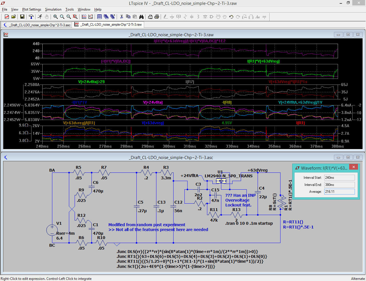

(((("weird")))) point here is the simulation showing no problems whether there is any output filter or not - even more weird is the phenomenon that is revealed by checking the I/O reversal ← actually this is all regular spice magic as the fast changing signals are not properly integrated by simulator and the component model substitute would likely represent the unsteady output nature of collector load regulators . . .
:eek: i want that "The end of the world" chip -- think of connecting input back to the output -- you don't have enough devices to power
