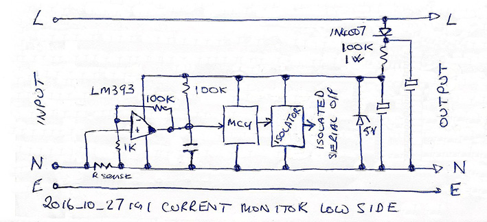

Here is an outline sketch illustrating the principle of a mains-voltage, low-side, AC current monitor. Note that this is not a practical circuit for construction.
spec
NOTES
(1) The circuit operates from a 5V supply line which is derived from 300V half-wave rectified mains
(2) The mains current flowing through 'R sense' generates a proportional voltage.
(3) The first stage, at the left, is a peak detector made from an LM393 comparator, which has an open collector output.
(4) The second stage is a microcontroller unit (MCU) which converts the 0V to 5V input from the peak detector into a digital stream (I2C, SPI, async), even wireless.
(5) The third stage is an isolator (optical, capacitive, inductive) which outputs the digital stream isolated from the mains supply.
(6) In a practical implementation, for safety, human contact with the above circuit would be prevented.

I need to analog measurement not peak detector.
If your mains supply is AC and not DC, you need to convert the voltage drop across the sense resistor, which will also be AC, into DC so that the analog to digital converter (ADC) in the processor can digitize the signal. A peak detector is a precision rectifier which accurately converts an AC voltage into a proportional DC voltage.
that is not practical because of without isolation ?
You have the wrong end of the stick.:)
The circuit I did is an outline circuit to show to you how a mains current monitor can work and to give you an idea of the size and complexity. It also shows how low voltage components can be used to measure currents at high voltage; the circuit could be configured for high side current monitoring too.
The circuit does have isolation; that is not why it is not a practical circuit. It is not a practical circuit because I haven't worked out the details. It just illustrated a principal.
In design there are various stages: concept > architecture > outline circuit > first draft circuit > circuit development > optimization, and so on. Of course, the stages vary according to the type and complexity of the circuit.
Don't worry.:D
