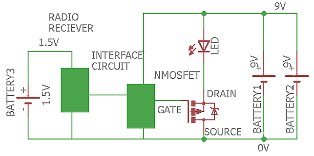

I have knocked-out the outline schematic below (based on assumptions) to illustrate the approach that I have in mind (pretty standard stuff) and I hope between us we can thrash out a detailed circuit to do your job. Most probably other members will also submit circuits/ideas so you may have a choice of approaches.:)

For the radio/NMOSFET interface, I envisaged an LM393 comparator or perhaps LM358 opamp (both chips include OV in their input voltage range), running off the 9V LED supply. That will be low cost and give maximum flexibility of the input signal. It will also hit the NMOSFET gate with a nice big voltage.:cool:

Apologies, but there is something out of kilter with the LED: a 9V, 10A LED= 90Watts, which would be onehellofa LED.
Also, as ChrisP58 implied in post #7, the maximum current a PP3 battery could supply is only around 200mA (0.2A) and then the terminal voltage would probably drop to around 6V. Also, PP3 batteries are troublesome little things.:eek:
My suspicion is that the LED may require a lower voltage and definitely take a lower current. Maybe you could make a couple more measurements to establish the LED characteristics if I explain what to do. Do you have a link to the supplier's web site?
