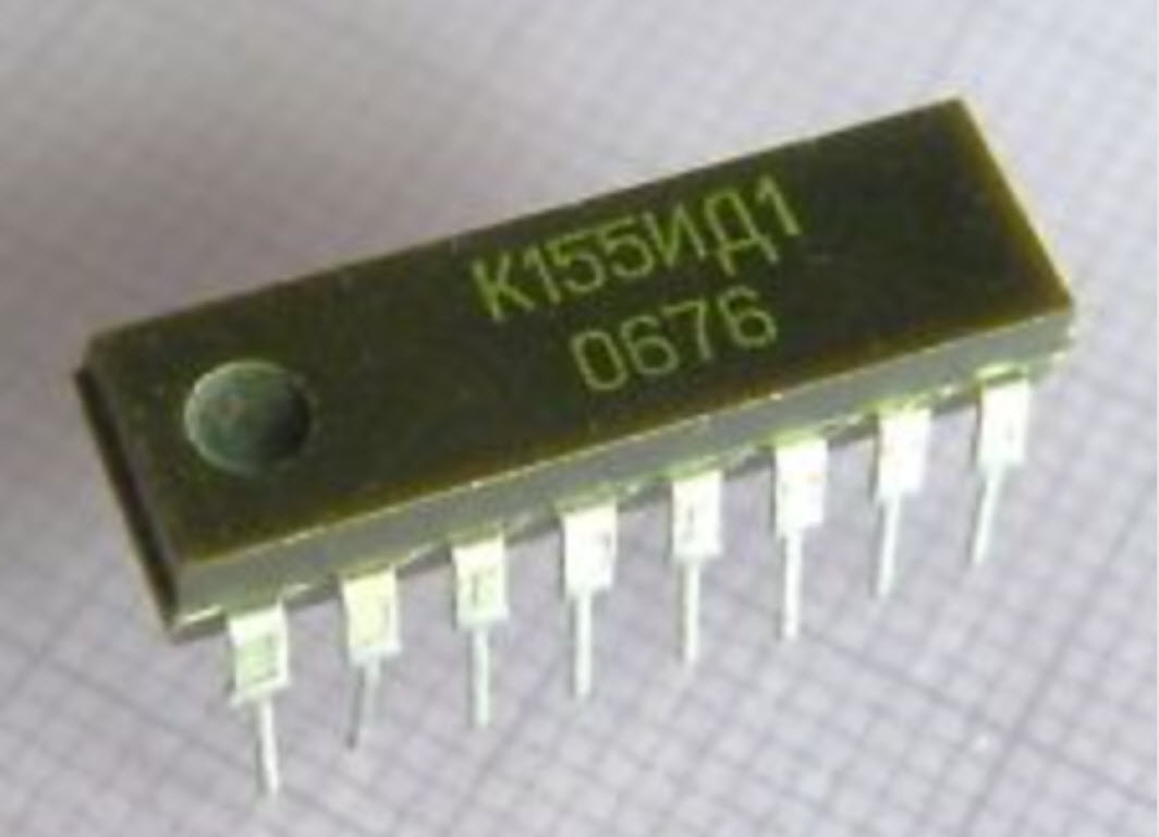

Sometimes you can find genuine 74141 IC's on eBay, often the Russian K155ID are sold, not sure how good they are but the prices are reasonable.
