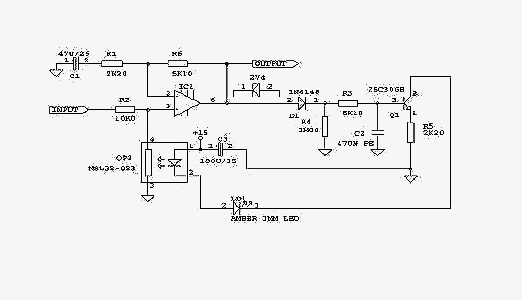

Hi Willen,
Well the speed of the audio wave itself is not an issue, it's a pure resistive element, a resistor, an LDR.
The LED internally shines on the LDR thus changing the resistance.
The speed of the audio can be almost anything, it's the speed of attach and decay that i was thinking of. If that is too slow it might sound like breathing in the background or maybe just take too long to response. The repeatibility also comes into question, as to the actual resistance the LDR returns to after a loud sound.
A typical part number i think is VTL5C4, but there are others, and you can make one yourself with a cadmium sulfide photo cell and an LED probably a white LED. As the LED gets brighter (ie more current) the resistance goes down.
Hello again,
Here is a circuit i found that uses the analog opto. The op amp for this circuit should be a low noise low distortion type op amp.
The main idea is that the current drives the internal LED, and the output is a variable resistance.
I am sure you can come up with other ideas too for this kind of device.

Willen, I think whats been said is that the audio isnt passing through the opto, moreover the resistive section is being used as part of a potential divider for the audio, sort of a electronic volume control.
The led side is filtered substantially and hardly any audio will be on it, the filter is usually designed to give fast attack (to prevent sudden sounds from passing) and a slow decay (to keep the sound down in case another loud sound comes along shortly after, and so as not to distort lower frequencies).
Passing audio through an opto isnt as easy as it sounds, most have a non linear frequency response, you'd have to either compensate for this using another opto or use one designed for audio, which is a special part.
Most low cost compressor circuits are like the link in post #180. A bipolar transistor, MOSFET, of JFET is the shunt leg of a voltage divider, and its effective resistance changes as a function of a rectified and filtered control voltage. A common problem is that the device's resistance also is a function of the audio signal across it. This introduces some amplitude-dependent harmonic distortion. High-end circuits use a gain cell (sometimes called a Gilbert cell) or analog multiplier to form a true VCA (voltage-controlled amplifier). The circuits are much more complex than a single transistor, but do not have any of the subsequent distortion issues.
A compromise between those two ends is the optical device mentioned in post #183. This is a light source and a photo-sensitive resistor like a cadmium sulphide cell. The resistance element goes where the transistor or FET goes. Since the resistance does not vary with the audio across it, you get the low distortion of a gain cell with the simplicity of a standard transistor limiter.
