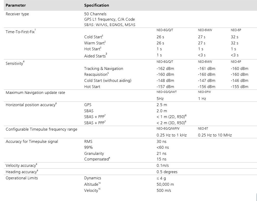

I just ordered this GPS. They brag about horizontal position accuracy of 2.5m.
I couldn't find that #6 footnote. We will see.
OPEN-SMART GPS Serial GPS Module for Arduino, APM2.5 Flight Control
<$8.00
https://www.dx.com/p/open-smart-gps...jMyPvDUcYC6a160EWaYaAlQBEALw_wcB#.WhC1YFWnH4Y
