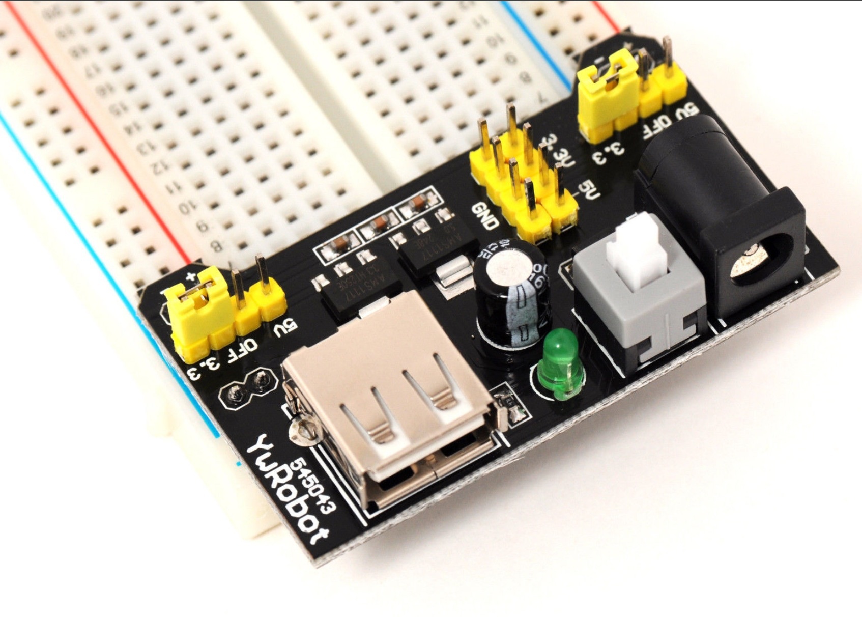

Another tip, for using a breadboard. Search on "breadboard power supply" on eBay. For a couple bucks, you can buy a circuit board like the one shown here. It plugs into the power rails of a breadboard, and provides 5v (directly from USB) or 3.3v from a regulator to each power rail. One rail can even be 5v while the other is 3.3v. These boards are offered by many vendors but all seem to be built by the same company. The price on these things is insane – cheaper than you can even buy the parts. Do note....not all breadboards use the standard rail – rail spacing.

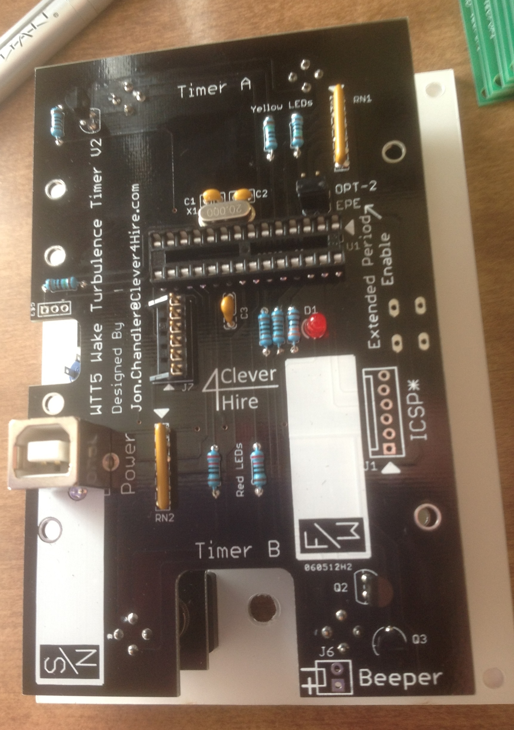

For a recent design, my client wanted to use a micro-B connector for power. This stack of boards is installed in a thick panel, with no clearance on the sides. As far as I can find, vertical mini-B connectors do not exist. To ensure enough room for the cable, I would have had to notch my board almost all the way through. That wasn't going to work!
We settled on a full-size vertical B connector, a standard USB cable and wall warts with a USB connector. These are available for less than US$5 new.
