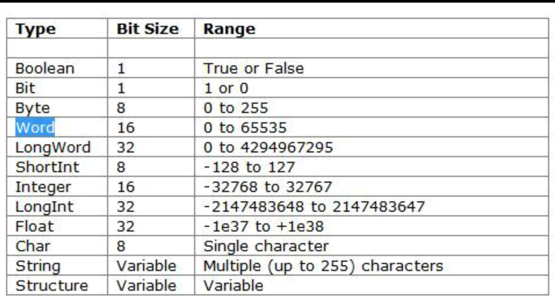

If you dimension a variable as a WORD, it's 16 bits.
In my above post the variable was SWITCHES.
Dim SWITCHES As Word
makes SWITCHES a 16 bit variable.
What to do with a 16 bit variable?? so I cobbled this together and it works as planned BUT still wanting to insert a cathode switch (see notes) as my PWM designation. This is just two of a total of 10 IF THEN statements. Plan on doing a little editing as per suggestions.

A "16 bit variable" is a word.
Dim Switches As Word
Search Swordfish Help for variables and alias.
You're probably not familiar with how forums work. You ask a question. People give you answers. For most people, these answers build on one another. Information is provided; information is expanded upon as needed. Forum posts build on the posts that have come before.
Pommie suggested a very easy, effective approach, gathering all the port bits into one variable, and comparing what it is now to what it was using XOR. A few lines of code, and you can detect every change in switch state (state is whether they are pushed or not).
You didn't know that a WORD contains 16 bits - i.e., a WORD is a 16 bit variable. I explained that and explained how to gather all the bits into a single variable dimensioned as a WORD and where to find the fancy words I had used in the Swordfish documentation. When your research still didn't help, I posted a table from the Swordfish documentation explaining each variable type. For example, a BYTE contains 8 bits. A WORD contains 16 bits. An INTEGER also contains 16 bits, but can represent positive or negative numbers.
And finally, I am pointing out to you the purpose of a 16 bit variable, since you seem to have forgotten.
